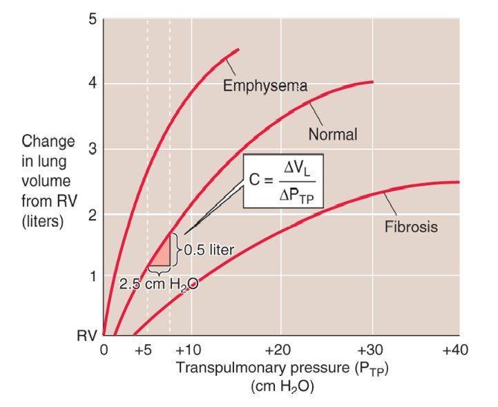

I am trying to replicate the curves in the attachment, but since I am a physiologist it has been quite a while since I've done graphing. I am simply looking for an easy way to replicate these three curves. This is for a practice exam I am creating for first year medical students. The graphing program I got from sourceforge allows you to create these curves by inserting a function in the form of f(x) = or creating a point series.
I believe the normal curve is roughly f(x) = √x but, I wish I knew what function to insert to make the line cross the X axis at +2.5 instead of 0. I am clueless how to create the shapes of the other two.

I don't see an attachment -- try again?
If your curve has the same shape as f(x) =√x, it can be translated to the right by 2.5 units to have an x-intercept at (2.5, 0). That would be y = f(x - 2.5) = √(x - 2.5)

I'm sorry, I think it should be attached now. Thanks for that first answer Mark. Now the other 2 curves should be in the attachment and I need a way to recreate them.
