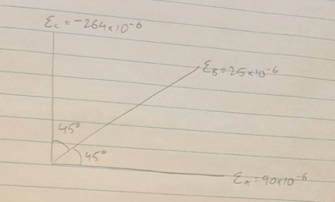

A sample is put in tension and a strain rosette gives the following results:
i) Calculate principal strains and poissons ratio using Mohrs strain circle.
ii) Calculate principal stresses from principal strains and poissons ratio.

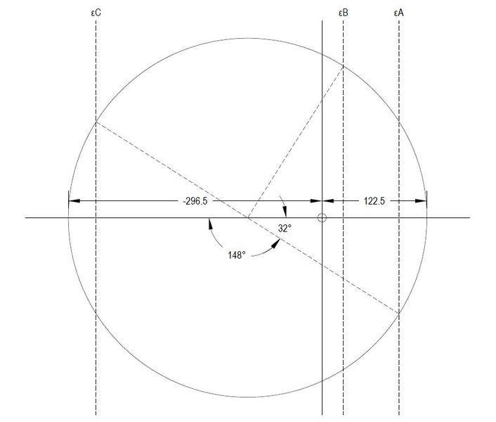

I have drawn up Mohr's circle in autocad and found the following results.
principal strains = 122.5x10-6 & -296.5x10-6
poissons ratio = -122.5 / -296.5 = 0.413 (this seems too high?)
principal stresses = σx = 11.5kPa (this is supposed to be low as the load is applied in the y direction?)
σy = -62.99MPa (should this be negative if its in tension?)
Im hoping someone can tell me if I am on the right track.
Thanks in advance!

Is this supposed to be plane stress or plane strain?

I confirm your principal strains. As far as the Poisson ratio is concerned, it seems that there is not enough information provided to determine it, unless the loading is uniaxial, and the principal strain in the z direction is also 122.5E-6.
