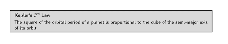

It depends on how nice you want your theorems to look. Here is a theorem I have in some notes:
Even though the far left line for the box doesn't show, it appears when printed. I have no idea why the pdf glitches and does that some times.
