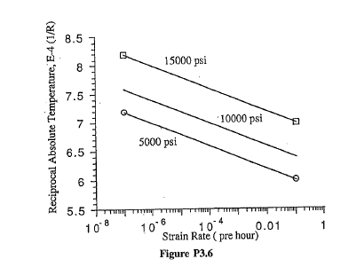

Figure P3.6:

- Don't use the middle line in figure P3.6 in my calculations.
- Start finding Q/k but for the top and bottom line, if they are not identical, deal with it.
- You will now have the temperature dependance.
- Plot ln(eps-dot)+Q/kT as a function of ln(Sigma)
- You get two points from which you can calculate n and B
