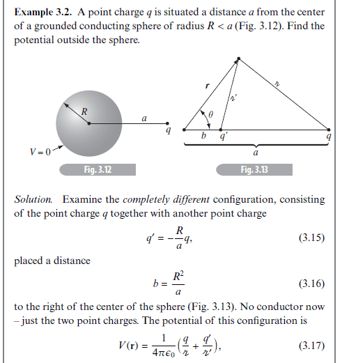

The method it refers to is that in 3.10 you were supposed to set q'+q''=0, where q' and q'' lie inside the conductor and represent the charge of the conductor, so for this problem you essentially do q'+q''=q where q'' lies on the origin of the sphere, q' lies a distance 'a' (inside the sphere still) and a third charge q is outside the sphere a distance 'b'. It's a modification of this problem.

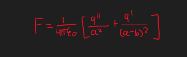

Does this seem like the correct expression for F using superposition?
Yes, except you left out the charge q in your expression for F.

Yeah my bad,
so I differentiate this and set it to 0? Pretend 'a' is a variable, maybe x, then I differentiate it like a variable right?
chaos333 said:
Yeah my bad, View attachment 348098
Still missing a factor of q. Otherwise, looks good.
