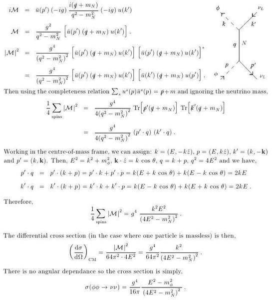

Hi. I'm trying to calculate the cross section for this process:
where [itex]\phi[/itex] is a massive neutral scalar, N is a massive Majorana neutrino and [itex]\nu[/itex]L is the normal SM neutrino.
N/A
Apparently the answer should be something like: [tex] \frac{g^4}{4 \pi} \frac{m_N^2}{ {(m_\phi^2+m_N^2)}^2 } \>, [/tex]
where g is the coupling constant.
There’s a similar case in http://zippy.physics.niu.edu/spinors/DHMspinors.pdf, page 45. However, I’m not sure which part of Eq. (4.5.13) corresponds to the diagram above and I don’t know how to deal with the [tex] \sigma \cdot k [/tex] term (particularly when calculating the invariant amplitude squared)?
Any help would be appreciated,
Thanks!
So, I've attempted to do the calculation. Does this look correct? (there are lots of steps I'm unsure about):
