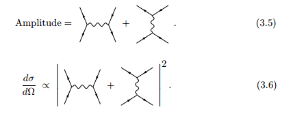

I know that for the second process ##e^+e^- \rightarrow e^+e^-## you can either have electron-electron scattering, or annihilation-production. So is the cross section for the second process simply twice of the first?

I would be surprised if it is exactly twice (you have to add amplitudes, not probabilities), but I don't know the factor. You can look it up.

I think the relation is given by
Calculation is given in http://physics.weber.edu/schroeder/feynman/feynman3.pdf

Your intuition is right. It's not a factor of two. It's infinite. You can have arbitrarily low momentum transfer in the electron case (so the cross-section blows up) but not in the muon case.

The thing is that there are different amplitudes, which for the muon and tau look the same.
The electron-positron has one additional diagram, which corresponds to scattering rather than annihilation.

As for the electron positron scattering, you would have a similar term which would correspond to your annihilation diagram squared, and two additional terms: 1 for the scattering and 1 for the interference of amplitudes.
I think this is given by Bhabha cross section.

Yup, the ultrarelativistic Bhabha differential cross section is:
[itex] \frac{d \sigma}{d \Omega}=\frac{e^4}{32 \pi^2 s} \Big[ \frac{1}{2} (1+\cos^2 \theta) + \frac{1+ \cos^4 (\theta/2)}{sin^4 (\theta/2)} - \frac{2 \cos^4 (\theta/2)}{\sin^2 (\theta/2)} \Big] [/itex]
If you try to integrate it (using right cuts for the angles to avoid the explosion of the cross section at the singular points) [itex] \theta_0 \le \theta \le \pi [/itex], you will get:
[itex] \sigma= \frac{4 \pi \alpha^2}{s} \Big[ \frac{1}{\sin^2(\theta_0/2)} + \log \sin^2 (\theta_0/2) + \frac{4}{3} \Big][/itex]
