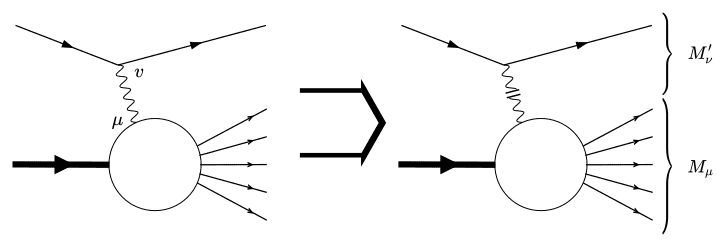

I am currently following R.K. Ellis et al.: QCD and Collider Physics, pp. 99 to understand how to arrive at the parton density functions starting from the matrix elements in electron-proton deep inelastic scattering (see figure below). But there seems to be a very fundamental concept that I don't understand at all.
In the book mentioned above, the matrix element is split up into a leptonic part ##M_\nu## and a hadronic part ##M^\prime_\mu## connected by the photon propagator (see figure below). From the hadronic part (without the photon propagator attached) they then calculate a matrix element, square it, average over spin, polarisations and colours and then calculate a differential cross section from it.
There are several points, which confuse me about this.
  • Matrix elements have external states attached to it. Here, however the leptonic part with its spinors is missing. How is it possible to define a physically meaningful S-matrix element from the hadronic part only?
  • How do the differential cross section of the entire Feynman graph and of the hadronic subgraph relate to each other?
  • How can I justify throwing out the entire leptonic subgraph from all my calculations, even when squaring the matrix element? After all ##|M|^2=|M_\nu\frac{-ig^{\mu\nu}}{q^2}M^\prime_\mu|^2\neq|M_\nu\frac{-ig^{\mu\nu}}{q^2}|^2\times|M^\prime_\mu|^2##.
The leptonic part is not thrown out, and the amplitude is not squared in the way you write it out here.

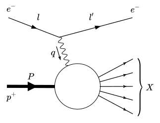

You look at the process ##e+P\to e+X##. Let's denote the momentum of the electron before and after the scattering by ##k## and ##k^\prime##, the proton momentum by ##P## and the momentum of the hadronic final state as ##P_X##, and define the invariants
[tex]Q^2=-q^2[/tex]
[tex]x_B=\frac{-q^2}{2P\cdot q}[/tex]
[tex]s=(P+k)^2[/tex]
with ##q=k-k^\prime##.
Then the differential cross section is
[tex]\frac{\mathrm{d}\sigma}{\mathrm{d}x_B\mathrm{d}Q^2}=\frac{1}{(4\pi)^2}\frac{Q^2}{s^2x_B^2}\sum_X\mathrm{d}\Pi_X(2\pi)^4\delta^{(4)}(P+q-P_X)|\mathcal{M}|^2[/tex]
The amplitude ##\mathcal{M}## to leading order in QED is
[tex]\mathcal{M}(eP\to eX)=\bar{u}(k^\prime)(-ie\gamma_\mu)\frac{-i}{q^2}(ie)\langle X|J^{\mu}(0)|P\rangle[/tex]
with the electromagnetic current of the quark fields ##q_i## of all possible flavors ##i## with charge quantum number ##\mathcal{Q}_i##
[tex]J^{\mu}(x)=\sum_i\mathcal{Q}_i\bar{q}_i(x)\gamma^{\mu}q_i(x)[/tex]
Then the spin-averaged square of the amplitude is
[tex]|\mathcal{M}|^2_{\rm{spin-av.}}=\frac{32\pi^2\alpha^2}{Q^4}L_{\mu\nu}\langle P|J^{\mu}(0)|X\rangle\langle X|J^{\nu}(0)|P\rangle[/tex]
where the leptonic tensor is defined as
[tex]L_{\mu\nu}=k_\mu k^\prime_{\nu}+k_{\nu}k^{\prime}_{\mu}-k\cdot k^{\prime}g_{\mu\nu}[/tex]
You see that the leptonic side is of course not thrown away.
When you define the hadronic tensor ##W^{\mu\nu}## as
[tex]W^{\mu\nu}=\frac{1}{4\pi}\sum_X\mathrm{d}\Pi_X(2\pi)^4\delta^{(4)}(P+q-P_X)\langle P|J^{\mu}(0)|X\rangle\langle X|J^{\nu}(0)|P\rangle[/tex]
then the cross section can be written in the simple form
[tex]\frac{\mathrm{d}\sigma}{\mathrm{d}x_B\mathrm{d}Q^2}=\frac{4\pi\alpha^2}{Q^2s^2x_B^2}L_{\mu\nu}W^{\mu\nu}[/tex]
The hadronic tensor can be also written in the form
[tex]W^{\mu\nu}=\frac{1}{4\pi}\int\mathrm{d}^4x\mathrm{e}^{ixq}\langle P|J^{\mu}(x)J^{\nu}(0)|P\rangle[/tex]
(which is equivalent to the definition above) and that is the object for which you can then calculate QCD corrections and which you can factorized into the PDF and the hard Wilson coefficient.
