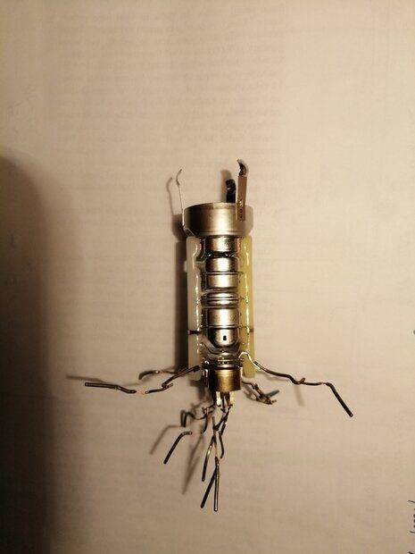

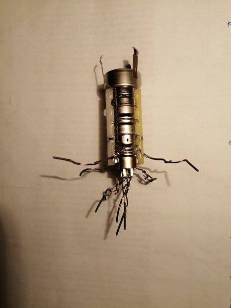

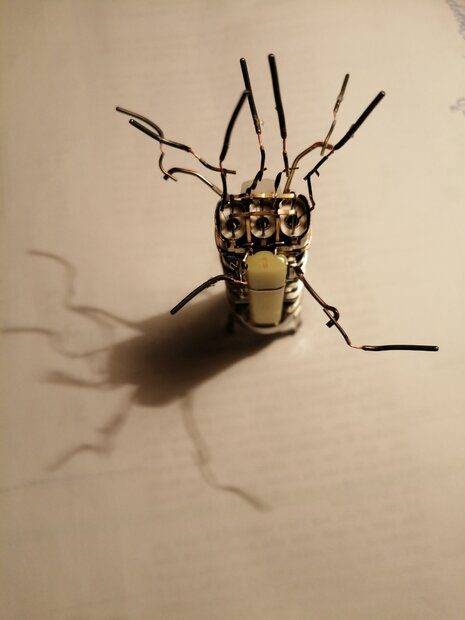

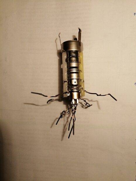

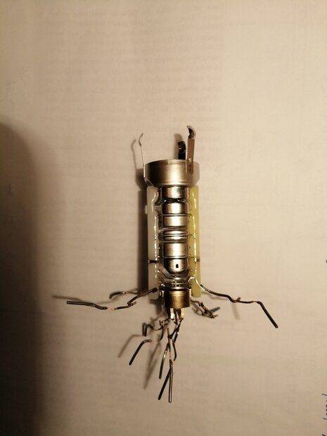

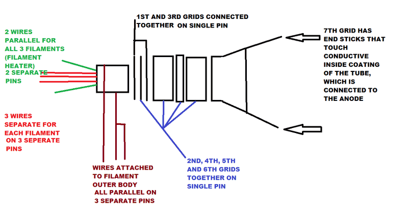

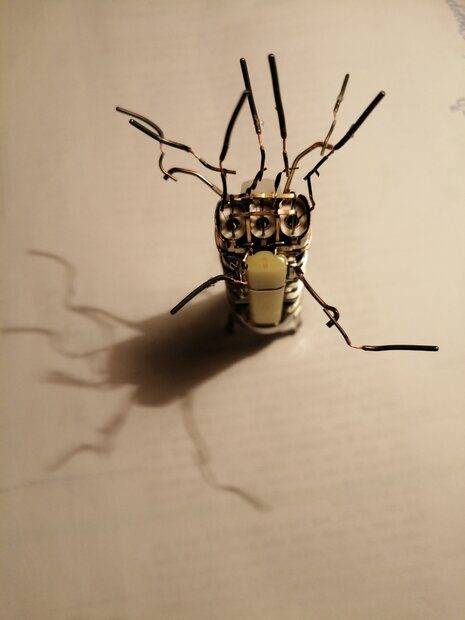

While messing around with old tv's I had a Panasonic sent the innards to recycling but at the factory kept some souvenirs , broke off the electron gun from the tube (that sweet swoosh sound when the air rushes to fill the vacuum).

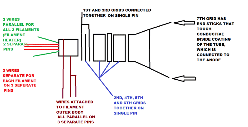

So long story short I know the basics of how an electron gun works but some questions arose upon closer inspection of the gun itself. I made a drawing representing the grids from the filament side up to the end of the gun.
Also made some (not that great) pictures of the real thing.
Now what I found bit interesting is that for example. The box housing the filaments themselves which I suppose is at ground potential (minus) has two parallel connections, one at either side. One of the connections extends through the glass as a single pin while the other connection on the other side extends through the glass as two pins, so a total of 3 pins are used all of whom are parallel.
Meanwhile all the other accelerator grids further on are connected parallel in pairs and each pair have just a single pin extending through the glass.
The last grid is not connected to any of the tube pins instead has 3 metallic sticks that once inside the tube touch the inner conductive coating of the tube which is electrically connected to the anode.
Then there are 2 wire with 2 pins that supply the heating current to all 3 filaments in parallel.
And then there are 3 separate pins with 3 separate wires going in the middle of each filament but not electrically connected to any other part.Now a couple of questions
1) Why are all other accelerator grids connected to a single pin but the filament box is connected with two wires that extend as 3 pins through the glass , why use so many pins for just one small attachment? To allow more current , if so why is that important ?2) The 3 separate wires not connected to anything else each going inside each separate filament, are they the 1st accelerator grid connection to each filament that are controlled by the video amplifier with which it can control each color gun beam intensity at each instant as the combined beam sweeps the horizontal pixel lines?
If so I suppose these 1st grids are the only ones whose voltage gets varied over time as the voltage on the further grids is fixed with respect to time?3) As for the accelerator grids, why are they connected like that, for example, the 1st and 3rd are connected together with the 2nd in between the two connected to the lower down the line grids? I always thought you would want each next grid to have a more positive potential to increase acceleration.
Also why are the last grids , namely , 2nd, 4th, 5th, and 6th all connected together? I can't quite understand why would you want multiple grids one after the other at the same potential , how does that help?
Please see attached files.

1. Filaments need amps, control grid signals need less than 1 mA. Metal with same thermal expansion coefficient as glass is resistive, so pins must be paralleled for filaments.
2. Three independent control grids, voltage relative to the cathode box.
3. Acceleration grids must also do electron optics. They focus the three beams onto the phosphor dots. Look at the electron exit from the cathode box. Is it the same shape as a screen stripe, so electrons will be projected to the far screen.
The end electrode appears to be the anode. As electrons exit that electrode they enter an electric field-free space. The end electrode contacts the aquadag inside the glass envelope, which is connected to the many +kV anode supply.
Yes I know that tube filaments tend to need low voltage current but I did some checking with ohmmeter, the 3 filaments themselves are all connected parallel with a total resistance of around 5 ohms. they are connected to two small busbars to which the output pins are connected. There are just 2 output pins for the filaments.
The 3 pins that I talked about which are all connected to the cathode box are just connected to the cathode box and the cathode box is not electrically connected to the filaments nor is it connected to the first accelerator grids individual for each filament.
Could it be that the electron beam current that is emitted from the filaments and accelerated by the grids, that some of that beam current strikes the cathode box and the connection to it are in order to bleed that extra negative charge away ?
The filaments themselves as said have just two pins for all 3 filaments and that's it.Now I wonder, as the video amplifier controls the voltages on each of the 3 individual small accelerator grids packed inside the cathode box, say that one of the guns is shut off for a while the grid turned negative, what happens with the thermionic emission of the electrons from the filament , the filament itself doesn't stop glowing. Are electrons still emitted during this moment, and if so where do they go?
I think you are making an assumption that the filament is emitting electrons when it is not. What you describe as the cathode box is the actual cathode and is the only thing emitting electrons of any substantial amount. It's what is known as an indirectly heated cathode.
Your essay was written, based on your first observations, that are themselves based on your earlier partial understanding. The pictures do not show the cathode, the control grid, nor the filaments.
We have insufficient information to be more precise. There seems to be nothing to discuss or explain.
The TV make and model, the CRT part number, and the circuit diagram would help.
Those 'grids' in the 'cathode box' are actually the cathodes of the three electron guns, where the video is applied at around 100Vp-p.
The grids themselves are where the beam shaping, focus, and astigmatism correction are done. These are service adjustments done with potentiometers (pots) by the service technician when a CRT is replaced or when some component drifts with age upsetting the viewing.
Hope this helps!
