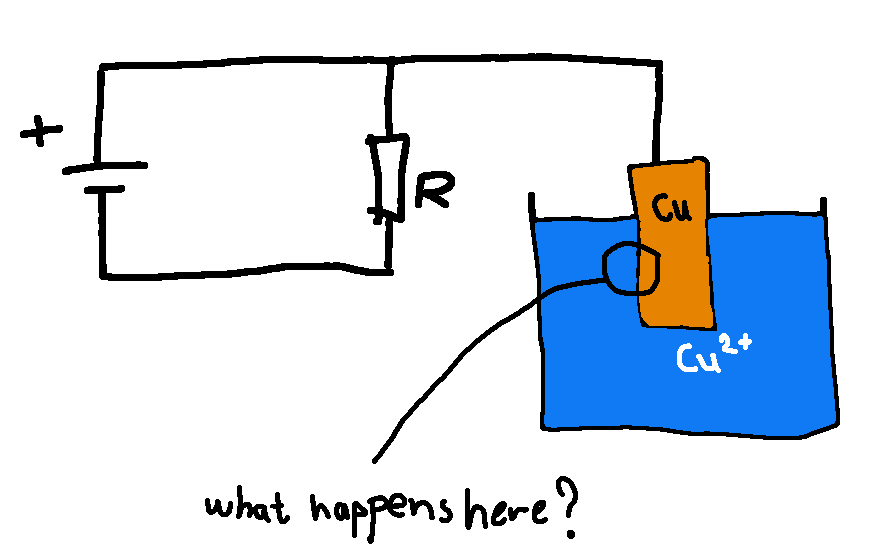

What happens in the boundary area between Cu(s) and Cu2+(a)? How does the various particles respond to each others presence?
Please behold my newest graphical masterpiece here below. The winner of this expensive artwork will be the first that can help me understand how the various particles respond to each others presence?
The Cu2+ is supposed to depict CuSO4 pentahydrate in water, so I guess the correct term would be [Cu(H2O)6]2+ if we are going to nitpick.

Nothing, as there's only one electrode. Get yourself another electrode, then things start to happen.

I would have thought at least one of two things would happen once the power is turned on:
1. The positive charges in the electrode will repel the positive charges in the aquatic solution
2. A neutrally charged boundary area will form at the electrode.
- or -
3. The passing negative charges (e.g. electrons) will attract the positive charges in the aquatic solution to the electrode.
And nothing of this would/could happen you say?
@mjc123 's point is that all of the voltage is dropped across the resistor (unless for some reason the resistor has a higher resistance than the air around the beaker).
I appreciate that. After further consideration I think I have provided too few details in my drawing, I should have inserted a switch between the power+ and the electrode/resistor net. This way it would have been clear that the circuit has two distinct states ON and OFF.

Imagine your resistor was gone, so that you just have a broken wire in its place. What would your circuit look like then? Keeping in mind that “circuit” comes from the same root as “circle.”

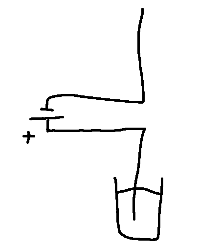

If I redraw the schematic based on "if the resistor was gone" it would look like this:
And that is nothing but a dipole antenna with one pole dipped into a vat of Cu2+
A power supply is supplying power by charge separation i.e. a power supply is nothing more than a charge pump that pumps negative charges from the positive pole to the negative pole.
When you turn on the power supply above, it will pump negative charges from the positive pole to the negative pole rendering the positive pole positively charged and the negative pole negatively charged.
Therefore the positive pole, which is positively charged, is surrounded by positive Cu2+ charges, and therefore my original question still stands unanswered: "What happens in the boundary area between Cu(s) and Cu2+(a)? How does the various particles respond to each others presence?"

The second diagram is basically a capacitor. Something interesting is happening there because there is a potential difference between the electrode/electrolyte and the opposite electrode. The accumulation of positive charge on the immersed electrode will attract a negative countercharge at the surface.
This doesn’t happen in the first diagram because all of the voltage is dropped across the resistor (I.e., there is no externally applied potential at the electrode).
However, at a molecular level, when a metal is dipped in an electrolyte, there’s almost always some inherent potential difference that causes accumulation of charges at the metal/electrolyte interface (regardless of whether an external potential is applied). Google “electrical double layer” for more information about this phenomenon.

First I would like to sincerely thank you for the above reply, that is exactly what I was wishing for, and it would be an excellent foundation for further discussion. There is so many things I wish to learn about this subject. And I'm sorry for the things we had to go through to come to this point and understanding.
