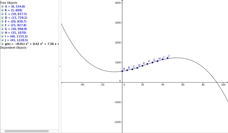

Yes, a Logistic is my next step, but this function here:
-0.0056755x^3+0.4186x^2+7.35529x+555.2542
Seems to me like it's leveling off towards the end, or is that impossible? It looks like it is possible from google images but you are probably a more trustworthy source :smile:
No, that one isn't leveling off. Because the coefficient of x3 is negative, the graph of this function is heading to negative infinity as x gets large.
Um,
Look :redface:
That's a pretty good fit, but is it likely that the population will die out in another 50 years? That's what modeling this data with a cubic spline is predicting. On the other hand, if the population is more likely to approach some stable value, then a logistic model is the way to go.
BTW, your first post says the data is for a five-year interval, but you graph uses about a 45-year interval. I suspect that you meant that the data represent populations at five year intervals.
