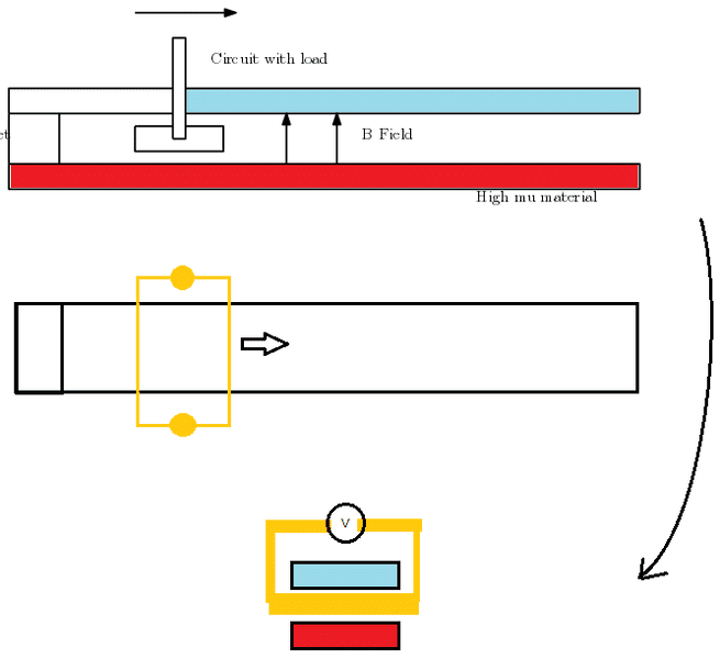

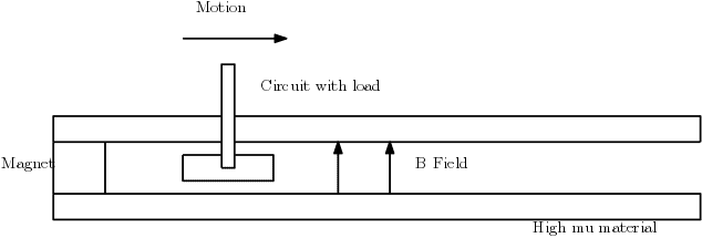

Why not use a linear pole gap and use translation rather than rotation.
So you have a conductor looped round one arm of a long horseshoe magnet?
And if you could get a uniform field, would there be any change of flux linked to the coil? I think so.
Certainly you should get an emf here.with the conductor moving through the field, uniform or not.
So how do we predict no emf here?
Likes Paul Colby
The magnet shown (ideally) applies 0 B field to the loop containing the load while applying a uniform B field to the plate in the gap. The emf in the plate arises from the ##v\times B## forces on the charges in the plate. Why would anyone expect 0 emf in this case? My reading of the OP is that this is a solution to the topological and physical problem posed. The load loop is fixed to the plate and the assembly is moving in a field applied to just the plate. Just from personal experience playing with linear motors there will be ample currents induced in plate. Makes an effective magnetic break.
