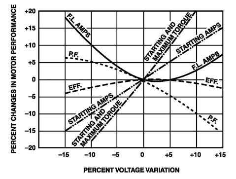

Power (3 phase) = 1.732 * V * I * PF
Power in watts, I=Amps, V=Volts, PF= power factor
Creating 37 kW of shaft power requires less current when the motor is supplied at a higher line voltage, and needs more current at lower line voltages.
An added consideration is shaft speed varies proportionally with line voltage, but pump power varies as the cube (see: pump affinity laws).
Is the motor voltage rating 380V? If so, then 390V is 2.6% above nominal, and 365V is 3.9% below nominal nameplate rating.
Inspect the generic curves above to gain a sense how voltage variation affects motor performance.
Three phase motors operate at fixed RPM and draw whatever current they need to generate the torque they need to keep spinning or fail trying.

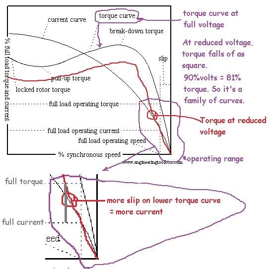

Induction motors have something called a "Speed-Torque" curve. It looks like this.
http://www.engineeringtoolbox.com/electrical-motors-torques-d_651.html
(the obvious annotations are mine)
Note how small is the operating range , circled in purple.
When you lower voltage, the motor runs now on a lower torque curve.
So it has to 'walk back up' that curve by slowing down a little bit , in order to make desired torque.
Walking up the torque curve also walks up the current curve. It will require more than normal running current to make full torque at reduced voltage.
That's why real long extension cords can cause an induction machine like a fridge or pump to burn up its motor.
hope this helps
old jim
