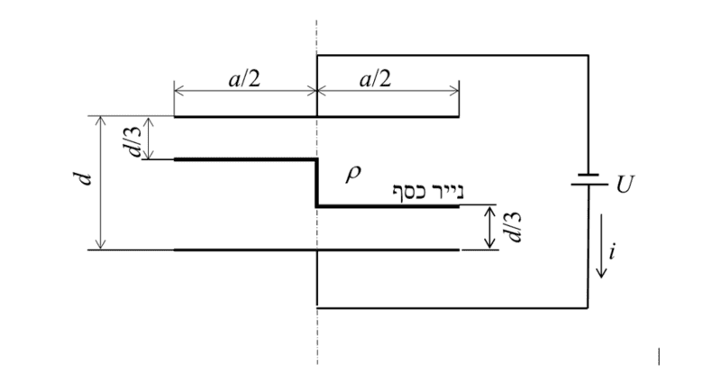

Given are two square parallel metal plates, with dimensions a×a whose distance between them is d where d≪a. The space between the plates is filled with a conductive liquid with resistivity p. The plates are connected to a constant voltage source U. How much will the current through the plates change when a conductive foil is inserted into the space between the plates and bent in the middle as shown in the figure? The current at any point between the plates flows in the direction perpendicular to the plane of the upper plate.
Circuit attached
I tried splitting it up into 4 individual resistors, adding them up (each side serially and then both sides with each other as parallel) and then using V=IR but it ended up being the same current as the original.
(The answer should end up being (9/8)* the original current)

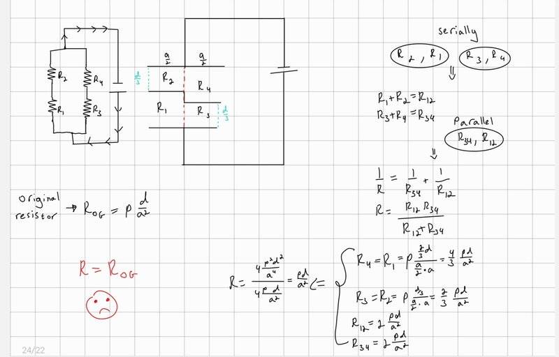

(The answer should end up being (9/8)* the original current)View attachment 333071

Here is my math
I hope it's understandable : )
I believe you left out the horizontal short-circuiting wire between the for 4 resistors... :wink:
I'm not really sure how to take it into consideration in the equations😅
The only information I'm given about the piece of foil is that it's conductive.
The foil is an equipotential. It is a zero ohms link across a bridge of four resistors. Solve parallel then series, not series the parallel.
  • Love
Likes student_man
Thank you! :biggrin:
