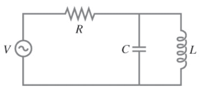

Current flowing through resistor in RLC circuit (C in parallel with L)
In summary: ELI the ICE man... ?)In summary, the conversation revolved around LRC circuits with an AC source and the confusion surrounding the best method to use for solving them. The conversation then delved into applying Ohm's law and computing the equivalent impedance for the circuit. The mistake of inverting the sign in the complex impedance was pointed out, leading to a discrepancy in the calculation of the phase angle. The correct expression for the phase angle was determined to be different by a factor of -1 due to the use of radians instead of degrees and the rotation direction of the phasors.
greg_rack
363
79
For the circuit shown, say ##V(t)=V_0sin\omega t##. Calculate the current in the resistor
V=ZI
Complex impedances: ##Z_R=R,\ Z_L=j\omega L,\ Z_C=\frac{1}{j\omega C}##
Hello guys,
LRC circuits with an AC source are having the best over me... had some confusion in class with respect to which method is best using(phasors diagram, reactances or complex impedances) which I am trying to desperately sort out before my exam; here I will show you my best attempt on this one, which although is missing on something!
Applying Ohm's law ##I(t)=\frac{V(t)}{Z_{eq}}=\frac{e^{j(90-\omega t)}}{Z_{eq}}##, and so the need to compute ##Z##.
Considering the schematics of the circuit, we can just sum up the various impedances accordingly to get to the equivalent one:
$$Z_{eq}=Z_R+(\frac{1}{Z_L}+\frac{1}{Z_L})^{-1}=R+(j(\omega C-\frac{1}{\omega L}))^{-1}=
R+j\cdot \frac{1}{\frac{1}{\omega L}-\omega C}$$
Substituting the result above and manipulating the equation:
$$I(t)=\frac{V_0}{\sqrt{R^2+\frac{1}{\frac{1}{\omega L}-\omega C}^2}}\cdot \frac{e^{j(90-\omega t)}}{e^{j\phi}}=\frac{V_0}{\sqrt{R^2+\frac{1}{\frac{1}{\omega L}-\omega C}^2}}\cdot e^{j(90-\omega t-\phi)}=\frac{V_0}{\sqrt{R^2+\frac{1}{\frac{1}{\omega L}-\omega C}^2}}\cdot sin(\omega t +\phi)$$
All we are left with is, at this point, to compute the phase angle ##\phi## which originated from taking the module of Z; for this, what I would do is: ##tan\phi = \frac{Im(Z)}{Re(Z)}=\frac{L}{RC(\frac{1}{\omega C} - \omega L)}## and then write the phase angle as the arctangent of such expression.
The correct result for ##\phi## is, though, ##\phi=atan\frac{L}{RC(-\frac{1}{\omega C} + \omega L)}##, which is what I get but multiplied by '-1'.
This really bothers me, because I am pretty sure to have not made any calculations mistakes and signs are a problem I've been getting quite often when dealing with such problems, which are still somewhat confused in my mind... this makes me think I am missing out on something more important wrt to AC circuits

The mistake is here, you write the term inside the (-1) power as inverse but you also inverse the sign, which is the mistake. So the correct is $$Z=R+j\cdot \frac{1}{\omega C-\frac{1}{\omega L}}$$
It is $$X^{-1}=\frac{1}{X}$$ and NOT $$X^{-1}=\frac{1}{-X}$$.

First, a comment about units. The Euler relation ##e^{j\theta} = \cos \theta + j \sin \theta## is true only if ##\theta## is expressed in radians (not degrees).
You expressed ##\sin \theta## as the real part of ##e^{j(90-\omega t)}##. This should be written as ##e^{j(\pi/2-\omega t)}##.
But ##\sin \omega t## could also be expressed as the real part of ##e^{j(\omega t - \pi/2)}##.
You can check that this second way of expressing ##\sin \omega t## leads to the correct sign for ##\phi##.
So, now you have a conundrum. ##\sin \omega t## can be expressed as either the real part of ##e^{j(\pi/2-\omega t)}## or as the real part of ##e^{j(\omega t - \pi/2)}##. Yet, only the second way yields the right answer for ##\phi##. Why?
Hint: When you use the expressions ##Z_L = j \omega L## and ##Z_C = \frac{1}{j\omega C}## for the complex impedances, then the phasors that represent ##V## and ##I## must rotate counterclockwise (not clockwise). Can you see why? (ELI the ICE man might help.)
Which way does the phasor ##e^{j(\pi/2-\omega t)}## rotate?

First, I agree with your calculation for the impedance Z, and it's phase shift Φ. But ##i(t) = v(t)/Z## there is a 180o phase shift in the division operation. The current is 180o out of phase with the phase of the impedance. I think the discrepancy is between the phase of the impedance and the phase of the current. OTOH, I pretty much ignored all of the ##e^{j⋅(stuff)}## it seemed pointless since you started with ##sin(\omega t)## and ended with ##sin(\omega t + \phi)## .

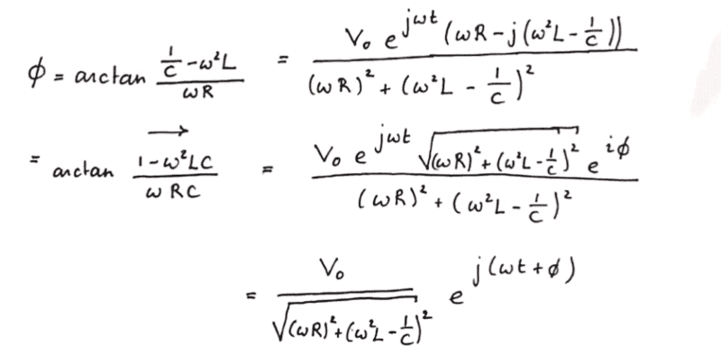

In my opinion the whole point here is that if the complex impedance has phase ##\phi## i.e. $$Z=|Z|e^{j\phi}$$ then the complex current has phase ##-\phi## and not ##\phi##, i.e. it is $$I=I_0e^{j\omega t-\phi}$$.
Does the problem asks for the phase of the current, or the phase of the impedance?

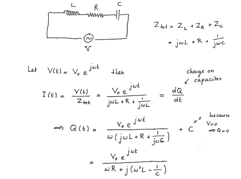

@Delta2 @TSny and everyone else, I will put here also another problem for which I had a very similar issue with phase signs, and for which what was pointed out in #4 doesn't seem to apply.
(sorry if I have attached the image directly, but I think it'd be much clearer)
So what happened here was that I was tasked with computing the amplitude of Q(t) across the capacitor in a LRC circuit in series. So same as before, calculate Z, start by assuming ##V(t)=V_0e^{j\omega t}##, write down the current as ##I=\frac{V}{Z}=\frac{dQ}{dQ}## and integrate over time to find a charge function ##Q(t)##.
Just carrying on the calculation takes me to the final expression(developed in column), with the argument of the e term being ##j(\omega t+\phi)##; now, same as before, by calculating ##\phi## "normally" we would get to ##\phi=atan(-(actual\ answer))## so what I did above, of course in hindsight, was just making a minus magically appear by writing ##\phi=\frac{-Imz}{Rez}##(don't tell my mathematics professor :oops:)... and so the solution for ##\phi## you find above is the actual correct one, but I don't know for which reason!
Hope I was clear, let me know what you guys think!
Likes Delta2
You have the charge as $$Q(t)=\frac{V_0e^{j\omega t}}{X}$$ where X is a complex quantity. You write X in the so called "polar form" that is $$X=|X|e^{j\phi}$$ where ##\phi=\arctan ...##. Then its simple complex algebra to see that $$Q(t)=\frac{V_0e^{j\omega t}}{|X|e^{j\phi}}=\frac{V_0}{|X|}e^{j\omega t}e^{-j\phi}$$, that is when the ##e^{j\phi}## goes from denominator to the numerator it has to become ##e^{-j\phi}##.

I think there is a mistake in the formula for ##Q(t)## it should be $$Q(t)=\frac{V_0e^{j\omega t}}{j\omega (j\omega L+R+\frac{1}{j\omega C})}$$ that is you missed a ##j## in the denominator. When you integrate ##e^{j\omega t}## the result is $$\frac{1}{j\omega}e^{j\omega t}$$
Oh yeah you are right, but this then would lead to a final minus in front of the whole expression for Q(t), right?
Performing all the calculations, after correctly integrating the e term, leads me to:
$$Q(t)=\frac{-V_0}{\sqrt{(\omega R)^2+(\omega ^2L-1/C)^2}}e^{j(\omega t -\phi)}$$
... unless I should have written the current as ##I=-\frac{dQ}{dt}## instead of ##I=\frac{dQ}{dt}## in the first place, so that the final minus cancels out:rolleyes: but why would this be the case?

No you shouldn't express the current as the negative of the charge derivative. What's the problem if there is a minus in front of there?
Yeah actually, none I would say. It is still a periodic function, so no big deal

It looks to me like you did your phase calculation for the complex denominator in the Q(t) expression. The minus sign you added was, again, because of division. Perhaps like this:
For a, b, c ∈ : ##arg( \frac{c}{a + jb} ) = arg( (\frac{c}{a + jb}) (\frac{a-jb}{a-jb}) ) = arg( \frac{c (a-jb)}{a^2 + b^2}) = atan(\frac{-b}{a}) = -atan(\frac{b}{a})##
