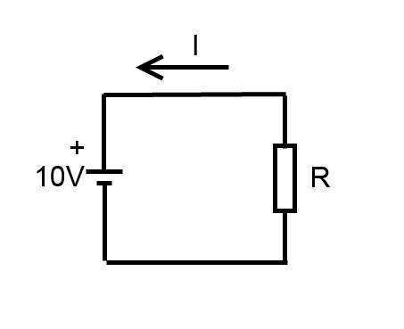

Regarding the direction...
Unless it's obvious the normal approach is to mark the diagram with arbitrary arrows which represent the direction you assume current will flow. Then solve the circuit equations to calculate the actual current. If the answer is negative that means current is flowing the other way.
For example see this circuit... Let's say I pretend I don't know which way the current will flow. To solve it I have arbitrarily chosen to define "Positive I" as flowing anticlockwise.
Applying KVL clockwise gives...
+10 + IR = 0
Note that it's "+IR" not "-IR" because if the current is flowing anticlockwise the bottom end of the resistor would be positive with respect to the top.
Rearranging this gives
I = -10/R
Oh look "I" has turned out to be negative. That means my assumption that the current was flowing anticlockwise was incorrect. In fact that's obvious in this example.
