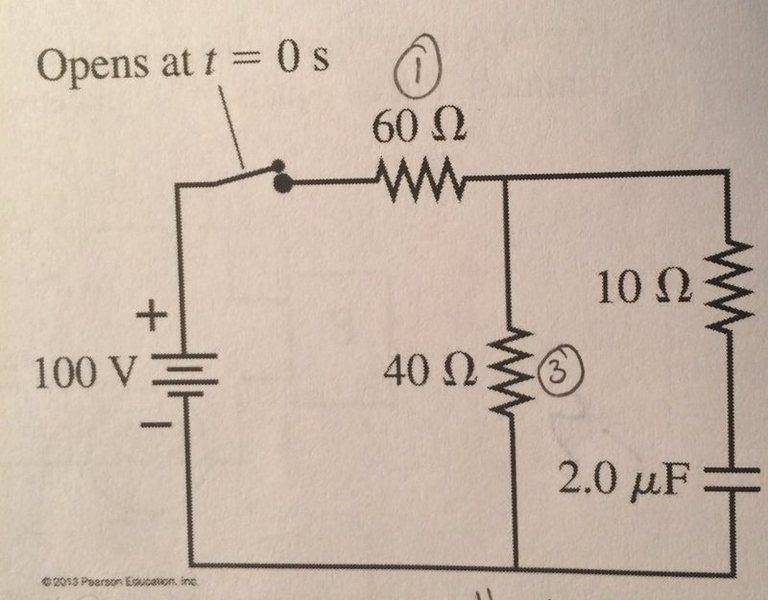

See attached image for circuit diagram and givens.
The switch has been closed for a very long time.
a) What is the charge on the capacitor?
b) The switch is opened at t=0 s. What current initially flows?
V = IR
Q=CV
I=I0e-t/(RC)
Since the switch has been open for a long time, no current flows through the 10 Ohm resistor. Therefore,
I = 100V/(60 Ohm + 40 Ohm) = 1 Amp, V = 1Amp*40 Ohm, and Q = 2uF * 40V = 80uC.
So my question is: Is the current that initially flows after the switch opens at t=0 s just due to the battery? So it would just be 1Amp? I'm having trouble understanding how to find the current at part b.

Hello MUU, :welcome:
First step is to establish where the current flows. Through an open switch ? Or elsewhere ?

I think you might have misread the problem statement. According to the wording in the problem statement, initially, the switch has been closed for a very long time. That means that current has been flowing through the battery for a very long time.
At time [itex] t = 0 [/itex], the switch is opened, meaning that after [itex] t = 0 [/itex] no current flows through the battery, and any current flowing in the circuit is the result of whatever residual charge is left in the capacitor.
At least that's the way that I interpret the problem.
(A "closed" switch means that the switch can conduct current. An "open" switch does not conduct current.)
