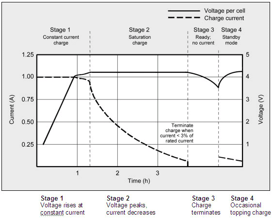

Here is a figure showing a typical charging protocol for lithium batteries. The figure comes from https://batteryuniversity.com/learn/article/charging_lithium_ion_batteries Note that voltage, current and power all vary with time.

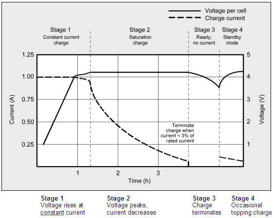

Looking at this, it seems that the current is passively controlled by whatever the voltage is over time, given a certain state of initial charge? And of course the voltage of the charging circuit would be controlled by typical boost or buck converter switching logic?

No. The charger must cover the entire range of 0% to 100% battery charge state. As you see on that curve, there are three regions. It is not as simple as an equivalent resistance.
I think most EV chargers are microprocessor controlled. They may use temperature feedback. They may use testing protocols, or vehicle history, to determine the state-of-charge when first connected to the charger. The intelligence for control of charging might reside in the vehicle, or in the charging station.

Not quite, most battery charge cycles fall into two basic stages, constant current bulk charge, and voltage controlled finishing charge. Note current doesn't have to be constant, but its more that while below some SOC, you can pile the current into a battery without worrying too much about the cell voltage.
During constant current charging, the cell voltage is monitored to determine the end point, and eg in Li ion, a knee in the voltage is detected to determine when to switch to voltage control mode. The voltage points at which end of charge etc are indicated are temperature dependent, so bat temp should be incl during the determination of those set points.
