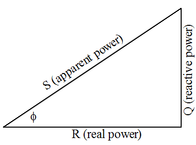

I presume that you have been introduced to the power triangle? Apparent power on the hypotenuse, real (active) power on the adjacent side, and imaginary (reactive) power on the opposite side?
The angle ##\phi## is tied to the impedance of the circuit, and thus the power factor. So long as the impedance is constant then the power triangle will have the same angle. If you manipulate the current to change the power, the triangle remains the same shape and just changes size. That is, if you change the magnitude of the current to change the power in the circuit then you just scale the triangle in size, producing a similar triangle (in the geometric sense of the work "similar").
So when you are asked to halve the active power by changing the current, know that in the complex domain real, reactive, and apparent powers will all scale by the same amount.
Now, in this problem you've already done the following:
1. Found the magnitude of the current required to produce the given apparent power in impedance Z2.
2. Found the magnitude of the current Ig1 that produces that current in impedance Z2: ##I_{g1} = \frac{\sqrt{2}}{25} A##.
3. Determined how to scale a current in order to halve the power in a circuit.
What remains is to state what the magnitude of the new half-power-current should be, and associate a phase angle with your Ig1 such that when 40 mA ∠ 0 is added to Ig1 the result is a current magnitude that matches the half-power current.
Let's start with the current magnitude. With the switch open the total current is ##I_{g1} = \frac{\sqrt{2}}{25} A##. Taking that as the "full power" current, what magnitude of total current will halve that power?
