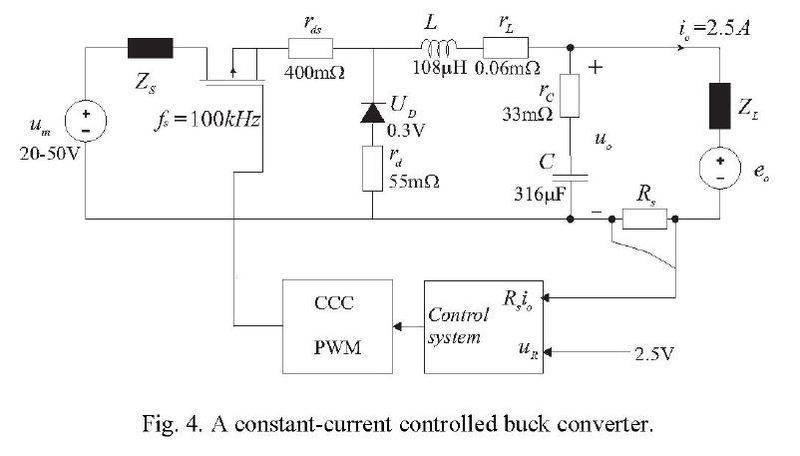

I am simulating a distributed power generation system for which I need a current regulation on a buck converter (for load sharing between sources)...The model will be turned into a hardware solution so I need a practical solution, preferably analogic.
I have only been able to find ressources (articles, books) about voltage regulation of converters.
Could I simply turn a current-mode controller (for voltage regulation) into a current controller, bringing the compensator into the current loop, and getting rid of the voltage control loop ?
Anyone has some experience with this?
Is there a good ressource on current regulation ?
Thanks!

Can I just use a sensing resistor on the inductor branch of the buck ?
Nonetheless, wouldn't a Hall effect sensor be more apropriate here ?
Here attached is one of the journal articles that I am using for the control strategy (see fig. 7). My problem lies in the design of the "current controller", which is said to be in "average current mode control". But to the contrary of standard control methods, there is no outter voltage loop.
I am kind of worried about stability issues, as it seems they are numerous with power converters, especially if an inverter is added between the load and sources (source load interaction/"input filter problem" ?)
I am surprised I can't find detailed info on current control for this type of application...

@jim_hardy : I took a look at your system. Quite interesting indeed, even though I am probably not experienced enough to grasp its elegance..! Thank you for the link (no i did not have it actually), some schematics could be useful to me.
While reading this pdf, as well as a journal article, made me wonder :
Would a SEPIC converter, instead of a buck, be more suitable to my application ? Since the converter would be directly connected to a fuel cell, couldn't a SEPIC limit the current ripple from the fuel cell, hence improving its durability while not requiring any sort of input filter..? (maybe i shld start a new thread for this)
Also, I think I will use some kind of sensing resistor, as berkeman suggested. What would be the reasons for not "standing low-side sensing resistor" ? (see berkeman's post)

@Claude :
My application is not about driving LED as you may have seen here above. But anyway, my goal is to track a current reference. That's what I meant by "current control".
In most applications, as you mentionned, the output voltage is to be kept constant. This is achievable through "voltage mode control" (1 loop), or "current mode control" (2 loops), where the inner loop modifies the pole/zero structure of the transfer function to be compensated in a favorable manner.
I am not aiming at using 2 loops, just one.
Indeed, as you explain, I will probably use a sensing resistor and doing "voltage mode control" (see attached image), except that my voltage reference (indeed equivalent to current reference, since sensing resistor is known) is not constant. Neither is my load, nor my voltage input (fuel cell).
Do you have a good ressource (scientific journal article preferably) for the control loop of a LED driver ?
