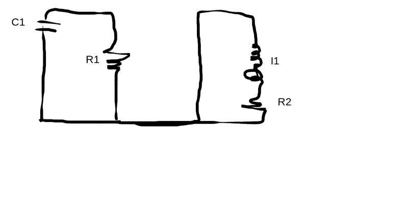

I have drawn a circuit below which causes confusion:
C1 is a charge capacitor, R1 is a resistor, I1 an inductor, and R2 another resistor, the bottom part of the circuit is the reference, with R2 << R1.
Suppose C1 is fully charged in the above circuit. What is supposed to happen is that all of its charge will leave and flow through R1.
Suppose that we add some kind of AC voltage source to make the voltage across I1 and R2 not zero. So now both parts of the circuit have current flowing between them.
My question is this: will any current from the capacitor go into the second part of the current, across the straight line at the bottom?
Will any current from the right loop go across the line at the bottom, to the left loop? Will any current from the left loop go to the right loop?
Since AC doesn't require a closed loop for current to flow, shouldn't the answer to that question be "YES" ?

Whatever is happening in the two sides of your circuit is not affected by the single common wire. There is no potential across that wire, so no current flows.

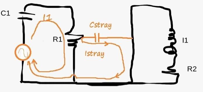

Let us add to your circuit
one voltage source
and a capacitor representing the capacitance between the two loops. Stray capacitance exists but at ordinary frequencies is too small to pass significant current.
It exists because real wires and resistors and coils have surface area, and area/distance between conductive surfaces is capacitance. Remember εA/D ?
So in your circuit as you drew it, no current traverses that straight wire joining the two loops.
But when you add the effect of stray capacitance, you create a closed loop around which current can flow per laws of Kirchoff and Ohm.
So it's back to "To what degree do you wish to push your analysis?"
In beginning circuit courses it is important to develop rigor in thought.
If professsor doesn't ask for paths through air, don't complicate your work by including them. That'll come when you get into RF design.

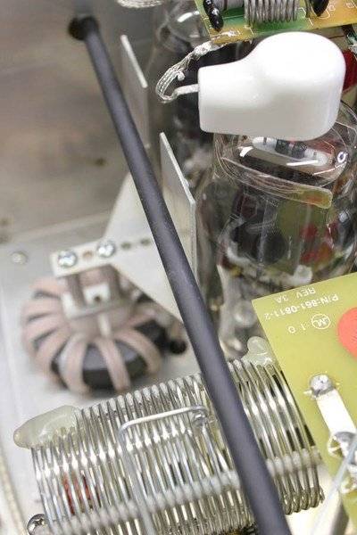

In this picture, the aluminum plate next to the radio tube is a "neutralizing capacitor" installed to create an intentional 'not so stray ' capacitance . Sometimes you'll see just a wire standing adjacent the tube - don't bend it it was adjusted at the factory ! Its purpose is to "neutralize" the effect of other stray capacitance(s)., observe the large metal "plate" inside the tube with its considerable area...
Always stick with Kirchoff. At beginning of our studies , developing rigor in our work habits is more important than wandering off into pedantic details.
