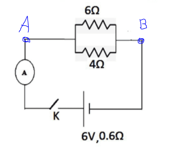

Consider the circuit diagram given below and answer the questions.
Ohm's law. V= IR
The equivalent resistance of the parallel combination is 2.4 ohm.
This implies that if the key is closed the total resistance of the circuit = R + r = 2.4 + 0.6 = 3 ohm
However, if the key is open, no current flows through the circuit and thus, by Ohm's law (R = V/I), as I tends to 0, R tends to infinity.
Thus, if the external resistance of the circuit is infinite, even if we add up the internal resistance of the battery ( 0.6 ohm), the resistance would still be infinity.
However, some of my fellow batchmates were fooling around with their reasoning as only the internal resistance of the battery would be taken into account and the final answer would be 0.6 ohm. They didn't provide a complete reasoning though.
Thus, the final question of this thread is what will be the resistance of the circuit, as the question questions and why?
Hi,
So it comes down to: is the 0.6 part of the circuit or not ?
I would say it is not.
I even find it questionable to say it's part of the circuit when the switch is closed, but this internal resistance must be taken into account to calculate the current when the switch is closed.
The reason for this is that one can for example investigate this 'circuit' with some other setup that doesn't include this particular battery.
No, because then V=0 too.

It's all about what you consider to be part of "the circuit" and what not. My subjective and somewhat inconsistent take is that "the circuit" under consideration does not include the battery if it is not connected.
It's more about communication than about physics.
The question asks for the 'resistance of the circuit'.
When the key is in the open position, the 'gap' is a resistor of infinite resistance. This makes the overall circuit resistance = infinity.
IMO.

Maybe there is some convention of which I am unaware. But we have an oval labelled "A" on the schematic. It has one terminal facing the bottom leg of the circuit and one terminal facing the leg on the top.
To me, the natural reading is that "the circuit" is everything between those two terminals. The oval labelled A is an unspecified sensor that is attempting to measure the circuit, trying to treat it as a voltage source in series with a resistor (Thevenin equivalent) or a current source in parallel with a resistor (Norton equivalent).
The wording of the question and the layout of the diagram seems to beg for the Thevenin equivalent interpretation.
With this interpretation, the voltage "over the circuit" can be whatever the sensor drives it to be.
I know I'm not going to win this. To my worn-out brainwashed mind 'the circuit' is what is between A and B on top and the remainder is plumbing.
Usually A (black, with a circle around it) stands for an Ammeter (and I haven't yet seen any of those 'attempting to do' anything or 'trying to treat' something.
As I said, it's more about communication than anything else. All in good spirit.
Consultation with an authority proves me formally wrong. Somehow I don't feel inclined to repent.
And I'd be surprised if 'Thevenin' means anything for the OP
(by the way, the exercise quality is lacking IMHO)

In my opinion, there is no “circuit” until there is at least one closed loop. For this reason, I think the resistance when the switch is open is zero.
The resistance of a short circuit is zero.
If you think that an open circuit is an oxymoron then you should characterize the resistance of an open circuit as "undefined", not "zero".
Likes PhDeezNutz
Fair. Resistance is a property independent of current (provided the voltage isn't too high and actually rips it apart changing it's properties). So even if there is no voltage drop across the element its resistance is the same.
Rethinking this I would say the resistance when the switch is open is
Again, the resistance between what point and what other point? Ideally, one defines and measures resistance using a four-point measurement. Here we are given no points! That's my point.

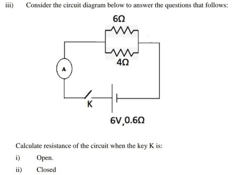

Here is a screenshot of this awful question for those still interested in it. I am not.
However, the answer given is 2.4 ohm. I don't know what they have assumed and why.
A 6 ohm and a 4 ohm resistor combined in parallel is equivalent to 2.4 ohms.
so which one should be correct and why? And if this is an incorrect-framing-of-the-question issue, please instruct me about the different resistances we can get if we consider different interpretations and different "points."
I can’’t help adding this.

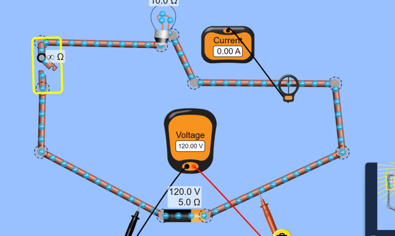

In real life, an open switch (or ‘key’) is not ideal. It has a very large - but finite - resistance. Let’s say around .
And a closed switch is not ideal. It has a very small – but non zero – resistance. Let’s say around .
A = circuit with switch closed.
B = circuit with switch open.
Note that B is the same circuit as A – except that the ‘resistor’ has been replaced by a ‘resistor’.
We calculate the circuit resistances in exactly the same way for both A and B.
For A we get (near enough) .
For B we get (near enough) (not or ).
The same argument applies with ideal components - the limiting case. So the circuit resistance of B is infinite.
If the question is asking about some other resistance, the question must define the required resistance clearly – it does not.
IMO.
