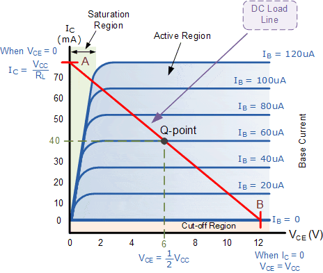

Something like this:
Plot two points ( A and B ) and draw a load line. Calculate Ib and you can read the Q-point, determining Ic.
( The figure is not for a 2N3904 ).

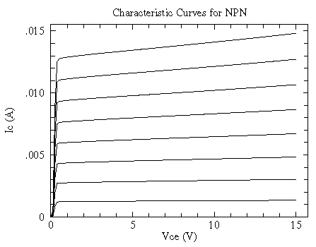

Something like this?
I kind of doubt that I have not been given sufficient information to answer the question without finding some obscure characteristics. But I also clearly have no idea what I'm doing, so my doubts don't hold much weight
I cannot read the base currents in the figure, but yes, that's it.
The characteristics are not "obscure" :smile:
Oh sorry, the graph is for IB = 10 µA, 20 µA, 30 µA, ... , 80 µA.
The highest resistor value in #1 is 50 kΩ → Ib = 188 μA.
That's a problem.
It's a problem because we don't have that data point on the graph? I'm almost certain the answer for the 50 kΩ is 0.0
Are the curves in #5 for a 2N3904 ?
( Curves differ for different types of transistors ).
0.1, 0.1, 0.0. I assume you're in Physics 140 at BYU? All you do for this problem is see if the transistor is on or not. To do this, the current going into the transistor from the R side has to be greater than 1 mA. If it is, then the current through the light bulb=9.8/100, or 0.1 in his class.
