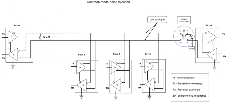

Does In the second paragraph what you have suggested mean by the following diagram?
The noise injected there is differential noise, not common mode noise. I would want to know why only slave 4 is isolated with a voltage transformer.
If you inject a current into the bundle then you must ask where the induced currents will go. You need a return circuit for current.

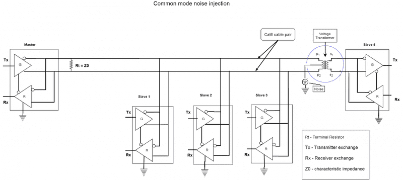

Earth or ground is not everywhere the same voltage. There can be big differences in voltage between different sites.
Modified to inject a common mode voltage.
Thanks for the modified circuit , Can you please suggest me the type of voltage transformer too with its ratings, if noise is of 10V (max peak-peak), Bandwidth - 100MHz ?
It's unclear to me that this modification does as advertised. Wouldn't an ideal center tapped transformer generate no flux in the core if the master line is balanced. Ideally this will not inject either a differential or common mode signal in slave 4. The transformers I've wound on toroids of this type tested at 90dB of isolation.

what you have said is correct, if the line is balanced it won't generate flux . That means, we should go for a toroid type transformer right? Can you suggest me how can I make a toroid by myself for my purspose? (Noise used is of 10V(max), 100MHz(B.W.))
I thought you were testing to see if the line was balanced and therefore immune to CM noise.

Actually my experiment is..The master and slaves are communicating using modbus protocol, and I need to analyze the effect of noise on data loss in this communication. The line length is about 1000ft and communication standard used is RS485.
  • #34
Okay, so maximum is 12Mbps so much less than 100MHz bandwidth centered on your baud rate should work, right?

That still sounds like a low-frequency version of EN 61000-4-6. We do tests like that all the time here in our lab.
Driving the center tap does cause a common-mode signal to be propagated down the wire. The fluxes do cancel, but the center tap is galvanically connected to both wires. The common-mode signal propagates down the wires to the receivers, which tests their common-mode rejection at their inputs. Especially for a DC-connected network like this one appears to be, the CM rejection will be pretty low. Nothing like it is for a transformer-connected multi-drop network.
EDIT -- the Leakage Inductances (Lk) will limit the bandwidth of this drive technique, but for the frequencies you are asking about, and the modest common-mode capacitance, it shouldn't be much of a problem. It's worth calculating it, though.
