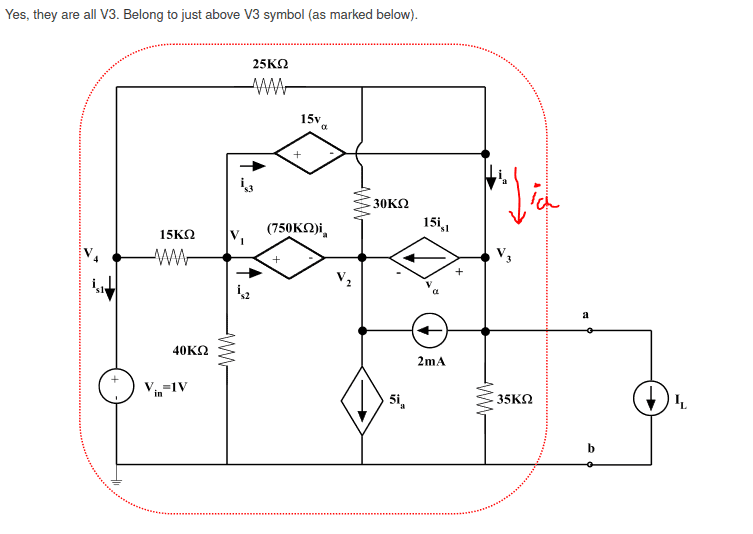

I'm supposed to solve this using nodal analysis. No biggie! I'm just not sure how to handle ia. I've never seen a current indicated in a junction crossing. I searched the web and my textbook and found zilch. I asked a GSI and was informed it is indeed written where is supposed to be. Within the node V3. Which has me puzzled. Best I could think of is it's specifically the sum of the 30k 25k & 15Valpha branch currents. Within my mind this interpretation is in superposition; it's flat wrong, and reasonable enough but odd and arcane if indeed correct. I can manage solving once I know how to approach ia, but can anyone weigh in on the spooky current?

It would appear to me that ##i_a## must equal the sum of
##15 i_{s1} + 2 mA + I_L + \frac{V_3}{35k\Omega}##
This presumes that the bottom "rail" is the assumed ground node as shown in the original circuit diagram.

You could substitute a 0V voltage source for any connection in that network, for example the connection that carries ia. That may help clarify your thinking about this problem. It's not just any connection, it's the one that they defined as having ia, the current in question. Because they asked about the current between the connections in this node, you have to treat it as two separate nodes with no voltage difference.
