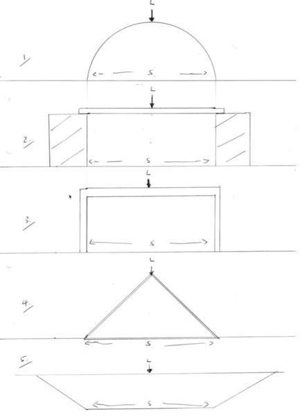

Here are some sketches to aid discussion.
The first set continues the motorway bridge theme. There are five ways shown to support load L above a span S.
1) An arch
2) A beam
3) A frame
4) A triangle
5) Despite the longer length, supports for bridges above motorways are usually raked back as shown
Each of these transfer the load L to the supports at ground level by different mechanisms
What do you think about each? In particular why do you think we rake back the supports as in (5)?
A curved shape is not the only strong shape. (1) and (4) have the same strength.

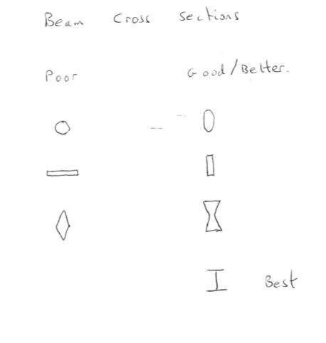

The second set shows cross sections of beams.
The further you can get the bulk of the material from the middle the stronger the beam. This is why we do not use round bars as beams. The steel is just as strong but the shape is wrong. We use [itex]I[/itex] sections.
Similarly if the rectangles were scaffold planks, I'm sure you have experience of which way round is stronger as the rectangles show.

Each of these transfer the load L to the supports at ground level by different mechanisms.
I will first look at the "mechanism by which each bridge transfers weight to the ground." Sketch 1 combines both the transfer of the weight to the ground and the suspension of the weight above the ground into one fixed structure. This differs from the rest, and is unique to the half circle. Through this design, the weight compresses and strengthens the structure as it concentrates the load to the abutments. I would imagine 4 to be similar in strength, but not necessarily equivalent. This is because of my previous explanation. I believe 2 and 3 to be identical. Each bridge uses a horizontal plane suspended by perpendicular piers. 2 may be stronger since less emphasis is being placed on the joints. In each of these, the integrity of the supporting plane will obviously be greatly influenced by the span S. 5 is similar to this design, but the "piers" have been raked as mentioned. Since this design typically entails the mounding of Earth for use as the piers, or the removal of Earth for a recessed road, the raked line pictured is just the retaining wall. The Earth itself supports the bridge. However, since the Earth is being compressed, and since lateral pressures increase when the retaining wall is made more vertical, the retaining wall is sloped back to prevent Earth pressure build up.
Can you explain this further?
I do not know if it is the same for steel, but I can speak for wood. The shear strength against the grain is incredible. However, shear strength with the grain is quite poor. Therefore, when "bridging" supports are needed with wood, and [itex]I[/itex] effect is used.
