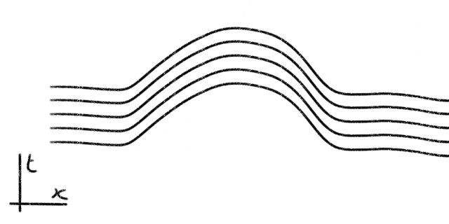

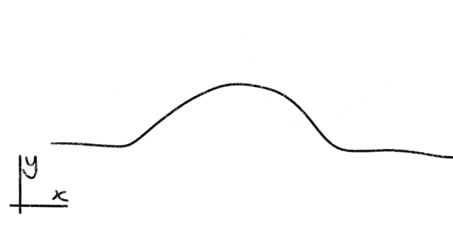

I think what @pahenning is envisaging is something like this:
We start with a flat 2d sheet embedded in 3d Euclidean space. Then we displace some set of points in the direction perpendicular to the sheet. A section through the result would look like
Then we change to a flat spacelike sheet embedded in (2+1)d Minkowski spacetime and do the same - the same diagram as above could be drawn, except with ##y## replaced by ##t##. Then we clone those sheets and stack them to form a spacetime:
Then we can ask questions about this spacetime.
Is that right, @pahenning?
If so, there are a number of issues that I see. First, you can't insert a hemisphere this way because the edge of the hemisphere is orthogonal to the plane and, when we get to stacking, it will intersect the plane above. Also, the plane would be timelike in part of it and null in at least one circle. There are limits to the displacements you can apply (in any Lorentzian signature spacetime, not just Minkowski) if you want your planes to remain spacelike. Second, the metric on the plane is induced from the metric of the space in which it is embedded. Is that meant to be flat Minkowski spacetime, or something else? Third, when we stack the planes, what is the "distance" (what ADM would call lapse and shift) between them?
All of this affects the spacetime you get. For example, if your embedding space is flat Minkowski spacetime and you specify (ref. my second diagram) vertical shift vectors and a constant lapse you just get flat Minkowski spacetime in weird coordinates. Other choices will give you other spacetimes. So there's quite a lot to answer before we can actually do anything with your model.

Yeah, but that is hard to visualize. Usually you have to drop all but one spatial dimension to show the distorted time dimension with an embedded manifold. Then you indeed get a "temporal bulge". See:

pahenning said:
Yes, Ibix, this is what I mean
That’s just a non-standard foliation of Minkowski space. A different set of curvilinear coordinates in special relativity with seemingly no particular usefulness.
Likes martinbn and Vanadium 50
