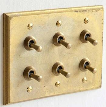

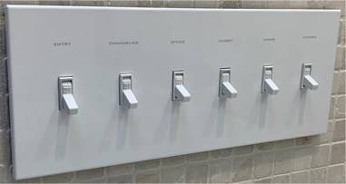

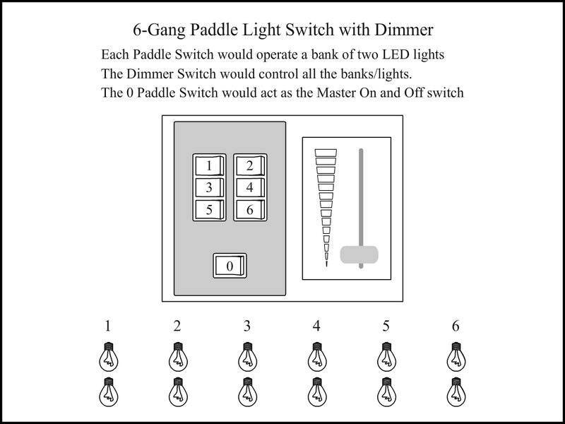

So, I'm guessing something like this may already exists (see image) light bulbs added for clarification purposes only.
Anyone know if there's something like this already on the market?
So, I did a google search for custom toggle switches but most if not all were for Marine or Auto applications.
They want $300 for this one
and this one doesn't quite do it either, but it was around $30

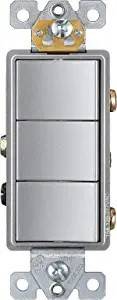

I then did a search for designer wall switches and Paddle Switches came up.
around $10 to $12
This 3-gang paddle switch has potential so I figured if I couldn't find what I was originally looking for I'll use them and add a dimmer switch.
That said, I may need help adding the dimmer to control all the lights, we'll see.
Can you describe in more detail what you are wanting to make? Do you want a central control panel that let's you control and dim multiple light fixtures? That would fall under Home Automation Systems, and there are a number of good candidates.
If you can give more details, I can probably suggest some good potential systems to use.

Here's some ideas.
Search Amazon for 6-gang electrical box. Here's one hit: https://www.amazon.com/dp/B00H8NV7ZO/?tag=pfamazon01-20.
Then search Amazon for 6-gang electrical box switch plate. Here's one (randomly picked) hit: https://www.amazon.com/dp/B0009KIMYM/?tag=pfamazon01-20. The covers are available for both toggle and paddle switches.
Use six standard toggle or paddle switches. The dimmer, which has a switch built in, would be in a separate 1-gang box. The wiring would be power to dimmer/master switch to all six individual switches to the six circuits.
Wander around the electrical section of a large hardware store, ask an electrician for ideas, look at manufacturers web sites until you find something.
I seem to recall seeing metal electrical boxes that could be disassembled and reassembled into as many gangs as desired. If those are still available, assemble a 7-gang box and put the dimmer next to the switches. You might be able to find a dimmer that fits the same switch plate as paddle switches. If not, you might be able to modify an existing switch plate. I did not look if 7-gang boxes and switch plates are available, that's an exercise for you.

I want to be able to target a section of our backyard deck or light-up the whole thing. The idea is to be able to control each group of lights individually (one set, three sets, all six sets, whatever) and then be able to dim them all with one dimmer.
So please, suggest away.Peace,
Yes, thank you. I saw these but I wanted something smaller and then I saw the 3-gang paddle set-up. I also saw a set of plastic gang boxes that can be snapped together to build multiple sections; I think each was capable of holding a standard 15A Switch or Outlet, but they were out of stock or sold out.Peace,
Element13
As this project grows, consider making those switches 3-way switches with center Off.
That way you can select each one for On-Off-Dim.

Are you suggesting a 3-way switch that would give me the choice of having the lights not dimmed if I so chose to? In other words, in position 1 lights are dimmable, in position 2 lights are off, and in position 3 lights stay on, at full, even if I use the dimmer?Peace,

Yes, that's why he said

Clarification not really needed, you got it Right On!
