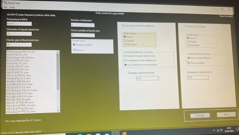

Now is the time to start finding and playing with free Yagi design software.
What is available these days?

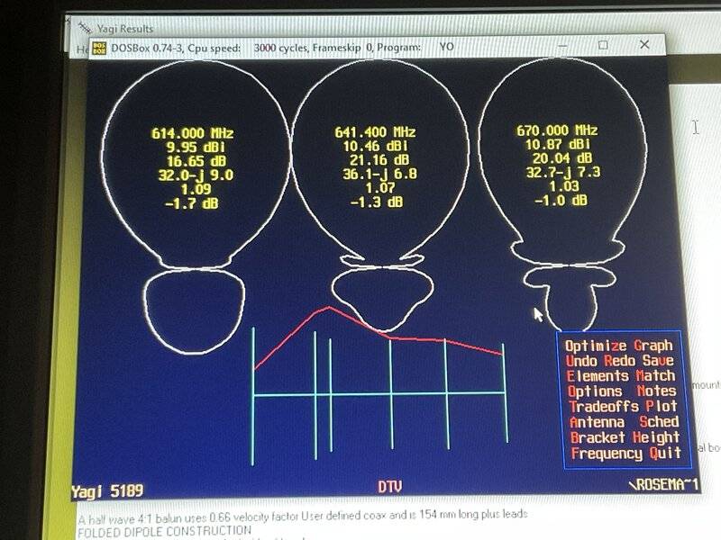

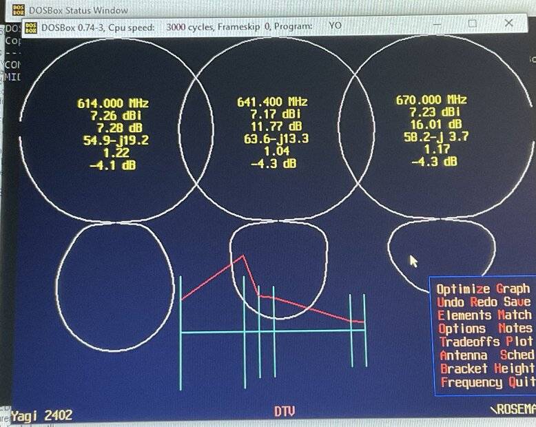

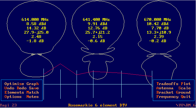

The first step is to design an approximate prototype, from λ/2 ±5% elements, spaced λ/4. For long, high-gain narrow-band Yagis, use DL6WU, or a modern derivative. (Not this case).
Search 'Yagi design software free'.
Then run something like the old DOS program YO, to optimise F/B and pattern gain at the centre and boundary frequencies. Get an idea for the way things trade. Change the number of directors to get the bandwidth required, while keeping the best gain possible across the band. Play it like a video game. Maybe there is a free copy of YO here.
https://www.iw5edi.com/software/yagi-optimizer
Warning: YO ignored element resistance, so could explode out of reality, into purely fictional, imaginary designs.
