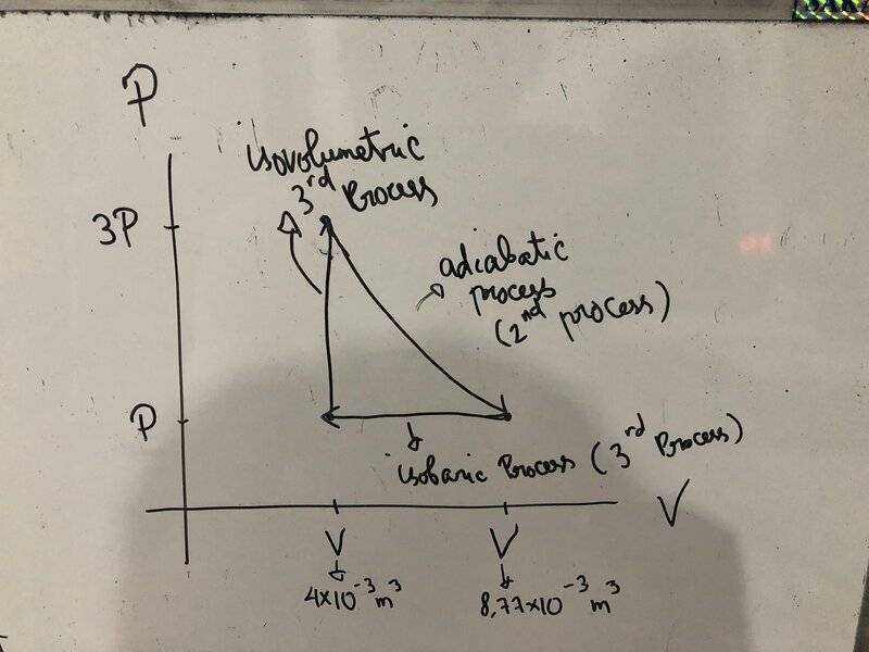

Can you not show us a pV diagram of the problem? Thanks.

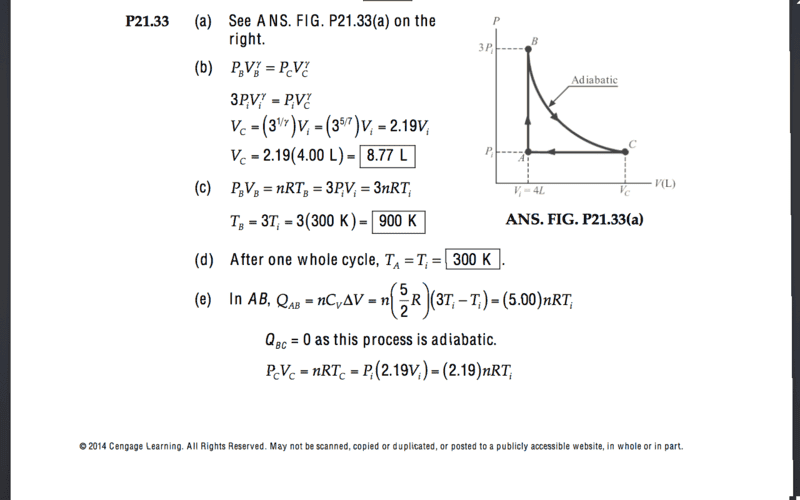

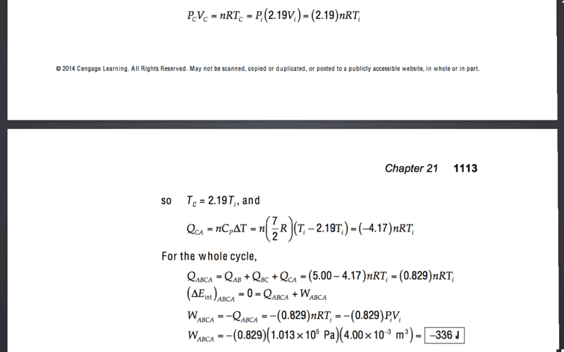

In the book, it states W = -Q since final temperature after the whole cycle equals to the initial temperature (300K), therefore, the change in internal energy is zero. Using 1st law of thermodynamics, W=-Q. The book evaluates the Q for each cycle, and then using change in internal energy = 0, W=-Q

oh, sorry, I forgot to include the diagram. Here it is. Mine's the one on whiteboard, it's a very rough sketch, and I will also include the diagram from the book

here is the method that my book used
EnricoHendro said:
here is the method that my book used View attachment 289160View attachment 289161
Oh. The form of the 1st law I work with is ##\Delta U=Q-W##, where W is the work done by the system on the surroundings. Apparently you use ##\Delta U=Q+W##, where W is the work done by the surroundings on the system.
Either of the two methods (yours or your book's) is acceptable. I would have used their method, because it seems easier (to me).
