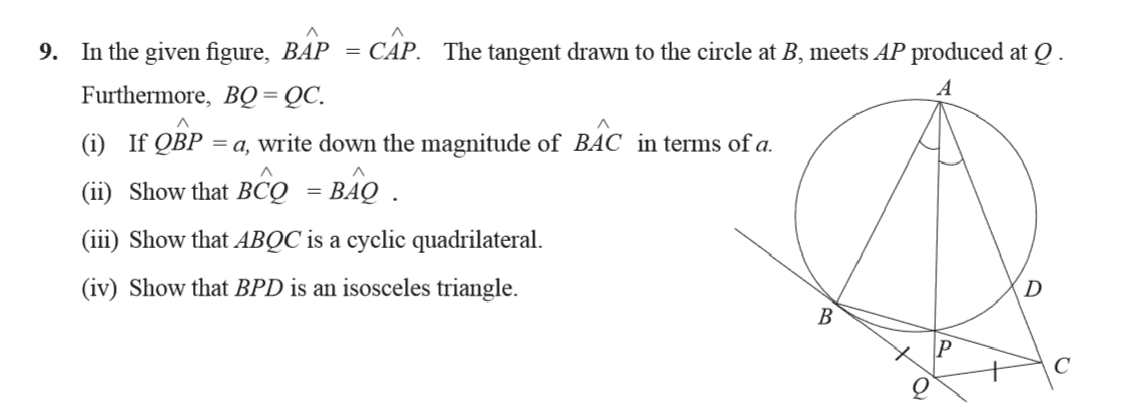

Here's the problem (Wait) (Sweating)
So, Any Ideas on how to begin ? (Happy)

Begin by reviewing the theory in your textbook about inscribe angles. Or see the theorem and its corollary in Wikipedia (you don't have to read the proof for now). Also read about cyclic quadrilaterals.
For I ,Alternate segment theorem ?
mathlearn said:
For I, Alternate segment theorem?
Yes.
Evgeny.Makarov said:
Yes.
$\therefore \angle QBP = \angle BAP = \angle QAC$
Therefore angle BAC would be $2a$
ii.Show that angle BCQ = angle BAQ
$\angle QBP = \angle BAP = \angle QAC$
$ \angle BAQ = \angle QBP$
$\therefore \angle BCQ = \angle BAQ $
Now how can ABQC proved a cyclic quadrilateral in iii.
Many Thanks :)
Agree.
I would recommend not to name the same angle differently within the same reasoning. This makes the proof hard to follow. Thus, use only one of $\angle BAP$ and $\angle BAQ$. More importantly, your two first lines in the last quote do not mention $\angle BCQ$, so it is not clear how it appears in the conclusion.
The converse of the inscribed angle theorem also holds: since $\angle BCQ = \angle BAQ$, point $C$ must lie on the circle passing through $A$, $B$ and $Q$.

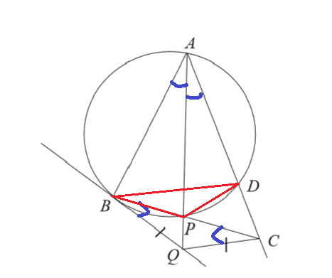

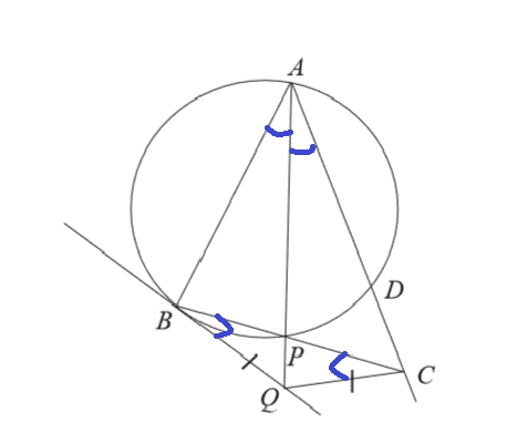

Including the new information found above , I updated the diagram
For ABQC to be a cyclic quadrilateral opposite angles should add up to 180 degrees.
Attempting.....
$\angle QBP + \angle PBA + \angle QCP + \angle PCD = 180 ^\circ $
$\angle BAQ + \angle PAC + \angle QBP + \angle QCP= 180 ^\circ $
Subtracting the two
$ \angle PBA + \angle PCD + \angle BAQ + \angle PAC = 0^\circ $
$ \angle PBA + \angle BAQ = \angle PCD + \angle PAC $...
Hmm. I am stuck with the proof any help with the proof would be appreciated (Happy)
You're almost there! $\angle{BAC}=2a$ and what is $\angle{BQC}$ in terms of $a$?
Then what is $\angle{BAC}+\angle{BQC}$?

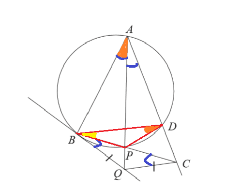

I very enthusiastically updated the diagram,
I have highlighted the $\triangle BPD$ using red coloured lines.
& I have no idea in the method this should be accomplished.
But I know how this should be done either to prove that $\angle PBD = \angle PDB$ or BP=PD.
I highly value your suggestion & advice. (Happy)(Smile)

Look at $\angle{BAD}$. Think "inscribed angle theorem" and that $\overline{AP}$ bisects $\angle{BAD}$.
(Yes) Thank you very much ,
As $\overline{AP}$ bisects $\angle BAD$ , The line that is equal in length AB and AD is PB.. It's meeting with the arc makes $BP=PD$, Correct ? :) or have i done wrong ? (Thinking)

First of all I would like to appreciate your patience (Smile)
(Party)(Party) Hope these will be the final steps.
Using the sketch I see the angles marked in Orange equal
But the other angle marked in yellow still remains a problem... Any help to make it equal to the other and and to prove that the triangle is isosceles would be appreciated
Sorry, I should have written $\angle{BAP}=\angle{BDP}$.
By the inscribed angle theorem, what angle is the same in measure as $\angle{DBP}$?

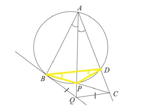

It should be $\angle PDB$ but to be exact which inscribed angle theorem are you intending here? (Happy)
No, I intended $\angle{DBP}$. Use your diagram and go over all the angles and see which ones you can find equivalence for using the inscribed angle theorem. This may help you to find your answer.
These are the angles that I find equal for now,
$\angle QBP = \angle BAP $ Alternate segment theorem
$\angle QBP = \angle QCP $ Angles in the same segment
$\angle QBP = \angle PAC $ Proved above
So these angles are equal $\angle QBP = \angle BAP = \angle QCP = \angle PAC$
How should I be saying that
