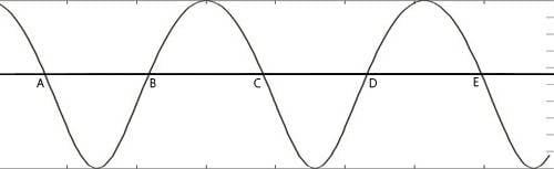

A charged particle (q), mass (m) is released from a frictionless inclined plane of angle θ under influence of Earth's acceleration (g) and magnetic field (B) perpendicular to (g) and plane of motion of particle. The particle slides down distance "l" along incline and then follows a cycloidal path with vertical displacement between highest and lowest point (h). Prove that [itex]l = h\frac{cot^{2}θ}{4}[/itex]
F= qv[itex]\times[/itex]B
In vector notation I took g as -g j. B as -B k.
Took instantaneous velocity as v= vxi + vy j.
Then formed a differential equation to vx and vy in terms of time. The point where it leaves the incline is the point of inflection of the curve. I bashed whatever equations I had to finally get the answer, but after doing this I think there's got to be an easy way to look at this. Can someone help me out?

The F=qvb=ma equation yield the following
[itex]m\frac{d}{dt}(v_{x}i + v_{y}j)=-qBv_{y}i + (qBv_{x}-mg)j[/itex].
Thus,
[itex] \frac{dv_{x}}{dt}= -\frac{qBv_{y}}{m}[/itex] and [itex]\frac{dv_{y}}{dt}=\frac{qBv_{x}}{m} -g[/itex]
[itex]\Rightarrow \frac{d^{2}v_{x}}{dt^{2}}=-(\frac{qB}{m})^{2}(v_{x}-\frac{mg}{qB})[/itex].
Let t=0 when particle is at bottom most point and velocity be [itex]v_{0}i
\Rightarrow v_{x}= (v_{0} -\frac{mg}{qB})cos(\frac{qBt}{m}) + \frac{mg}{qB}[/itex].
Further, [itex]y= (v_{0} - \frac{mg}{qB})\frac{m}{qB}(1-cos(\frac{qBt}{m})))[/itex].
Clearly, [itex]h=\frac{2m}{qB}(v_{0} - \frac{mg}{qB})[/itex]
As can be seen [itex]x= aθ + bsin(kθ) and y=ccos(kθ) [/itex]. Thus it happens to be a cycloid.

OK, I'm inclined to do away with the particle staying on the incline :redface:
Argument: B doesn't do any work, so potential energy at highest point = potential energy at releasing meaning h = l sinΘ, so not the cot2/4. I took ##\vec B \bot## the plane -- as I was told.
So we continue with
  • the assumption ##\vec B## is NOT ##\bot## the plane but in the horizontal negative z direction
  • we look at free fall in a magnetic field with inital condition ##v_0^2 = 2 l g \,sin\theta/ m##. (So ##\vec v_0 \cdot \hat\imath = v_0 \cos\theta## and ##\vec v_0 \cdot \hat\jmath = -v_0 \sin\theta##)
Do we agree so far ?
I agree with BvU's v2 = 2l sinθ/m. This is the 'takeoff point'. I now see a system of two diff. eq. in x and y with new initial conditions on vx and vy. I would impose a new coordinate system with x=y=0 at this point to clean up the equations in x and y.
I also got the OP's dvx/dt and dvy/dt equations, but then I don't follow the rest to where he/she gets h. If that h is correct then we have a problem getting the answer, seems like.
I would pursue solving the system of two diff. eq. in x and y, solving for y(t) and getting h that way. (I would use Laplace, but whatever).
@theQmechanic: I used the word 'spiral' loosely. The exact shape is of course determined by the equations. It's undoubtedly a cycloid as you and the question state.
