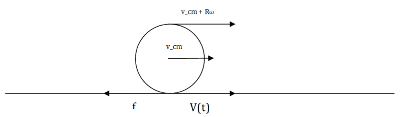

Yeah I have been suggested before about the fact that ##V(t)## should appear on my ##v_{CM}## equation. This is because the motion of a rolling object is the combination of the translation and rotation! My bad.
This is what I think it happens:
So the translational velocity of the centre of mass is:
$$v_{CM} = \frac{3R \omega}{2} + V(t)$$

kuruman said:
What is the instantaneous velocity of the point on the cylinder that is in contact with the belt?
##V(t)##

JD_PM said:
##V(t)##
Yes, I think it is safe to assume that the points of contact are at rest with respect to each other, i.e. kinetic friction does not play a role here. Now pretend that you are sitting on a chair placed on the belt, in other words transform to moving belt's frame. The belt is at rest relative to you and so are (instantaneously) the points on the cylinder that are in contact with the belt. Would you see the cylinder move? If so how would you analyze its motion in the belt's frame of reference? Once you do that, you can transform back to the room's frame of reference.

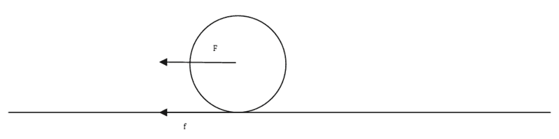

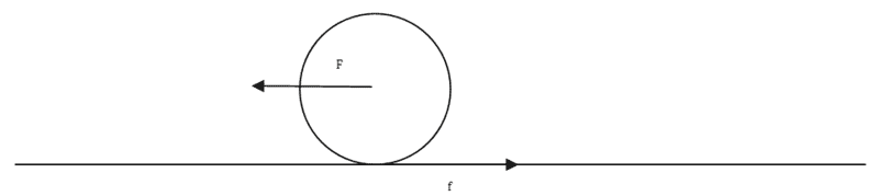

But this is not the only force exerted on the system. There is a fictitious force ##F## acting on the COM of the system.
Here it is a picture of what is going on (there was a mistake in the attached image to this post, now fixing):

On a non inertial frame of reference we have the following scenario:
Where ##F## is the fictitious force and ##f## is the static friction.
Though I am not sure, as I am wondering if they should be opposite instead...
Actually, after having some thoughts, I think F should point backwards and the friction force forwards. Thus the diagram flaws.
Ok, though I believe they would be inopposite directions, but that doesn't matter. If so, the sign will come out negative.
So what equations follow from that?
OK let's carry on with opposite directions. Using Newton's second law for translation we get:
$$-F + f = ma_o$$
$$a_o = \frac{-F + f}{m}$$

Now I am confused on the following:
I know that the translational speed of the centre of mass for pure rolling motion on a non moving floor and measured from an inertial reference frame is:
$$v_{CM} = \frac{ds}{dt} = R\omega$$
Where ##s## is the arc of the cylinder
But how is it possible that I get ##2R \omega## just with the difference that in this case the floor (belt) is moving?
  • #34
My solution is obtained from an inertial reference frame.
@kuruman you were interested in solving the problem from a non inertial reference frame. why?
  • #35
haruspex said:
That does not mean anything unless you specify the axis.
What about the angular acceleration?
I would say that the axis plays a role if we use:
$$\tau = I \alpha$$
The angular acceleration is obtained from the stated equation:
$$\alpha = \frac{\tau}{I}$$
