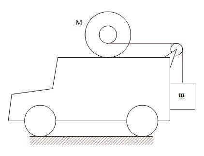

A truck with a cylinder of mass M and moment of inertia ##I=kMR^2## on top has initial velocity v0 and decelerates with deceleration B. the cylinder is attached with a rope to a weight m. the coefficient of friction is μ.
The outer radius of the cylinder is R and the smaller is r. The cylinder moves without sliding and there isn't friction between the weight m and the truck.
What is the relation between the angular acceleration of the cylinder and the linear acceleration of the weight.
What are the forces and the moments that act on the weight and the cylinder.
What is the linear acceleration of the cylinder in the reference frame of the truck.
What is the condition on B so that the cylinder will move to the right relative to the truck.

For the first part, it is not clear whether the acceleration of the mass is wanted relative to the truck or relative to the vround. Asuuming it's relative to the truck, I believe R should feature in the answer. If the cylinder rotates an angle theta, how far does it move relative to the truck? How far does a horizontal piece of the string move?

The relation between the accelerations:
$$\ddot{x}=R\ddot{\theta}-r\ddot{\theta}=\ddot{\theta}(R-r)$$
The moment of inertia round the point of contact with roof:
$$I_a=kMR^2+MR^2=MR^2(k+1)$$
The tension in the rope is T. in the frame of the truck d'alambert:
$$\left\{ \begin{array}{l} Tr-MBR=kMR^2(k+1)\cdot \ddot{\theta} \\ mg-T=m\ddot{y} \end{array} \right.$$

D'alambert:
$$\left\{ \begin{array}{l} T(R-r)-MBR=MR^2(k+1)\cdot \ddot{\theta} \\ mg-T=m(R-r)\ddot{y} \end{array} \right.$$
$$\rightarrow \ddot{\theta}=\frac{mg(R-r)}{MR^2(k+1)+m(R-r)^2}$$

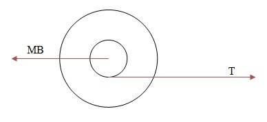

If you want to take moments about the cylinder's centre then you will need to introduce the force of friction between the cylinder and truck. This contributes both to the rotational acceleration and the linear acceleration in the lab frame. It's the latter that relates to B, R, r, ##\ddot\theta##, ##\ddot y##
The acceleration of the center: ##B-R\ddot{\theta}##
Moments round the center:
$$M\left( B-R\ddot{\theta} \right)R+Tr=kMR^2\ddot\theta$$
But the friction f and T act in the same direction, relative to the center and it's not true, B rotates counter clockwise and T clockwise.
If i could take moments round the contact point for T and round the center for f it would be better.

I have trouble keeping track of which way positive is being defined for these variables. For the equation in post #7, with which I agree, I believe B is defined as positive to the right and theta as positive clockwise.
On that basis, if a is the linear acceleration of the cylinder's mass centre, to the right, in an inertial frame, ##a = B+R\ddot{\theta}##. If the frictional force on the cylinder is F to the right,
##F+T=Ma=MB+M\ddot\theta R##, ##kMR^2\ddot\theta=-FR-Tr##.
I believe that putting those together leads to the same equation as in post #7.
Likes Karol
Inertial frame:
$$\left\{ \begin{array}{l} F+T=MB+M\ddot\theta R \\ kMR^2\ddot\theta=-FR-Tr \\ mg-T=m\ddot\theta (R-r) \end{array} \right.$$
$$\rightarrow \ddot\theta=\frac{mg(R-r)-MRB}{MR^2(k+1)+m(R-r)^2}$$
Truck's frame:
$$\left\{ \begin{array}{l} T(R-r)-MBR=MR^2(k+1)\cdot \ddot{\theta} \\ mg-T=m\ddot\theta (R-r) \end{array} \right.$$
It gives the same
Now i change the sign on the right:
$$\left\{ \begin{array}{l} T(R-r)-MBR=-MR^2(k+1)\cdot \ddot{\theta} \\ mg-T=m\ddot\theta (R-r) \end{array} \right.$$
$$\rightarrow \ddot\theta=\frac{MRB-mg(R-r)}{MR^2(k+1)-m(R-r)^2}$$
You see that the value, not only the sign, of ##\ddot\theta## has changed because the denominator is different, i didn't expect that.
So the decision which is the positive direction of the angular displacement changes the value of ##\ddot\theta##? not reasonable
If you change the direction in which the angle is measured then all occurrences of ##\ddot \theta## in the equations must flip sign.
Likes Karol
haruspex said:
Because you have chosen T as positive right, theta as positive clockwise, and R-r is such that an actual positive T would lead to an actual positive angular acceleration.
An actual T to the right will still lead to an actual clockwise torque, so its effect on theta would then be to reduce it, so you'd need to write -##\ddot\theta##.
You mean to say that i have to consider the whole torque side, the left side of:
$$M=I\ddot\theta\rightarrow T(R-r)-MBR=MR^2(k+1)\cdot \ddot{\theta}$$
I have to consider not only if T gets a positive value, because there is also the term -MBR
haruspex said:
The question you have to ask yourself is one of consistency: if T takes a positive value in this equation will the torque be clockwise or counterclockwise? Will the equation give me a positive or negative angular acceleration? Does that match with the sense of the torque?
So if the system, in this case the cylinder, actually yields to the torque and rotates in the same direction of the torque, that is what i have to consider, right? and by that direction to decide, in accordance with the positive direction of θ that i have decided upon, which is the sigh of the right side of the equation ##M=I\ddot\theta##, the ##I\ddot\theta## side?
What is the condition on B that the cylinder will rotate right relative to the truck?
$$\ddot\theta=\frac{mg(R-r)-MRB}{MR^2(k+1)+m(R-r)^2}$$
$$\ddot\theta>0\rightarrow mg(R-r)-MRB>0 \rightarrow B<\frac{mg(R-r)}{MR}$$
