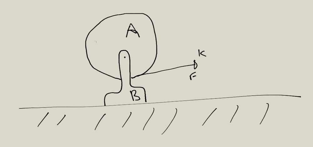

A solid cylinder A of uniform mass given ##m_1## can rotate freely along an axis fixed to a support B of given mass ##m_2##, also given. A constant force ##F## is applied at the extremity (point ##k##) of a light thread firmly rolled in the cylinder. The friction between the support and the horizontal place is negligible. Find the acceleration at point ##k##.
Equations of linear and rotational motion.
This comes from a list of exercises, and setting ##m_1 = 5.4kg##, ##m_2 = 9.3kg## and ##F=5N##, the answer should yield ##2.19m/s^2## (of course, supposing the answer is right).
If I knew the radius ##R## of the cylinder, I could find its momentum and use it to find the linear acceleration. I'm really mystified on how to go about this problem without the radius 🤔
(sorry for the poor drawing :p)

It could be that ##R## cancels out in the calculations so that the answer doesn't depend on ##R##.
You will probably need to think about the relation between the linear acceleration of ##k## and the linear acceleration of the center of the cylinder.

Yes, that's right. It's actually not complicated after thinking a little, we have (##a_k## denoting the acceleration at the point k):
\begin{align}
a_{cm} & = \frac{f}{m_1 + m_2} \\
\tau &= f\cdot R = I\cdot \alpha = \left(\frac12 m_1 R^2 \right) \alpha \therefore \alpha = \frac{2f}{m_1R} \\
a_R &= R\cdot \alpha = \frac{2f}{m_1} \text{ (and this is where the R cancels)}\\
a_k &= a_{cm} + a_R = \frac{2f}{m_1} + \frac{f}{m_1 + m_2}
\end{align}
and plugging the values yields the expected result. It was a simple problem - it's just I was "blocked" from seeing it, so to speak. Anyway, thanks for the encouragement 👍
