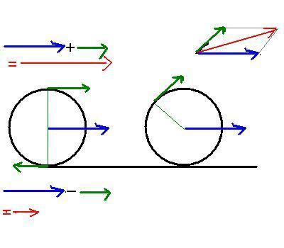

Edit : The question is to determine the relation between the top point of small cylinder and its acceleration of center of mass
And what is your question?
My book says that
atop-point = acm + α r
acm = α r
So,
atop-point = 2 acm
But, I don't understand how atop-point = acm + α r comes from
What I know is that atop-point = atan = α r (since it's rolling without slipping)
If the top point of the small cylinder accelerates more than its center point, it will roll with slipping, right ?
The points at the perimeter of the cylinder move with respect to the centre, so their relative velocities add to that of the CM.
At the top, this velocity has the same direction as that of the CM. The bottom point has relative velocity opposite to the CM. The speed of the perimeter is ωR, so the tangential speed of the bottom point is Vcm-ωR, that of the top point is Vcm+ωR.
In case of rolling without slipping, the bottom point is in rest with respect to the ground. So Vcm=ωR. At the top, the velocity is Vcm+ωR=2Vcm.
The same is valid for the tangential acceleration.
ehild said:
The points at the perimeter of the cylinder move with respect to the center, so their relative velocities add to that of the CM.
So, for a cylinder or ball or anything that's rolling, the tangential acceleration is not just α r, but acm+α r , right ?
And if it's rolling without slipping, the tangential acceleration is 2 α r ?
Or the formula is just relevant for the cylinder whose top point is linked by a string to a center of another cylinder ?
The tangential acceleration of a point on the perimeter depends on the position of that point. On the top, it is acm+α r. At the bottom, it is acm-α r, and both are horizontal. The tangential acceleration at a general position is the vector sum of the horizontal acceleration of the CM and the tangential acceleration with respect to the CM .
The blue vector is the acceleration of the CM. The green vectors are the accelerations with respect to the CM. The magnitudes of the green vectors are the same αr. The red vectors are the sum of the blue and green ones, the tangential acceleration of a point of the perimeter with respect to the ground.
Thanks for your help :)
You are welcome :)
