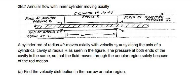

0=viscous forces
0=in-out+sum of forces(0)
2*pi*r*L*τrz evaluated at r-2*pi*r*L*τrz evaluated at r+ΔR (eq1)
Dividing by volume and taking limit as δr->0 in eq1 I get :
(δτrz)/(δr) =0
My question is, how did they in solution got
(rδτrz)/(δr) =0, how do they have that additional r in the numerator?
My question is: how did they in solution got (rδτrz)/(δr) =0, how do they have that additional r in the numerator?
Because when dividing by volume and taking limit as Δr->0 I get (δτrz)/(δr) =0, so my solution is lacking that r in the numerator, compared with theirs, but why, what is wrong?
Suppose they wrote the force balance equation the way it should have been written, as
$$2\pi rL [\tau_{rz}]_r-2\pi (r+\Delta r)L [\tau_{rz}]_{r+\Delta r}=0$$
Would this make any more sense to you?

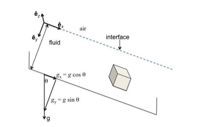

In the below picture(Fig1) it is pretty much intuitive that the flow will be on y surface in x direction, and that P(y).
fig1-illustrates falling film

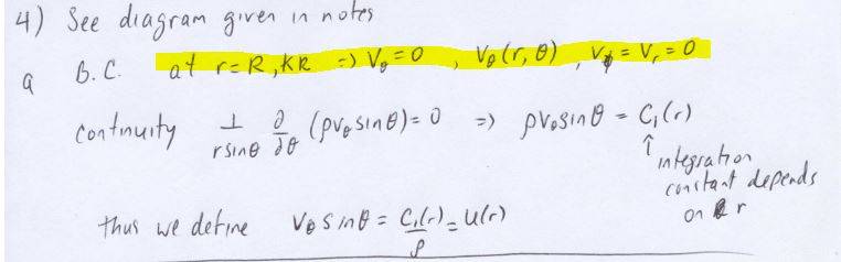

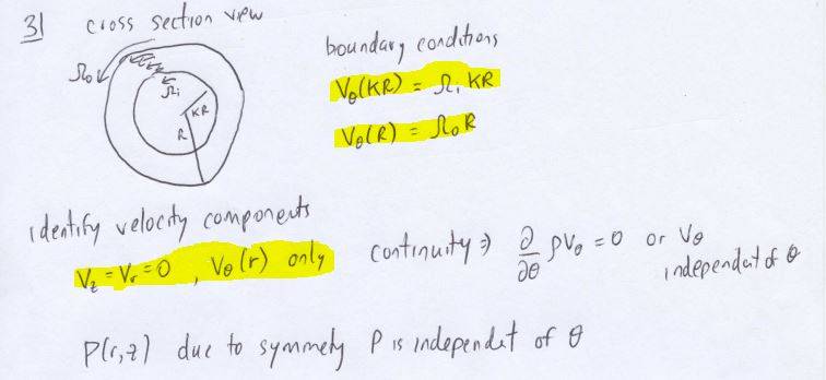

However in the following pictures, how does he know that the velocity and pressure is like that(please see the highlighted text)
fig2-illustrates The space between two coaxial cylinders is filled with an incompressible fluid at constant temperature. The radii of the inner and outer wetted surfaces are κR and R, respectively. The angular velocities of rotation of the inner and outer cylinders are Ωi and Ωo. Determine the velocity distribution in the fluid and the torques on the two cylinders needed to maintain the motion

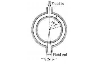

fig3-illustrating A very viscous Newtonian fluid flows in the space between two concentric spheres (as shown in Figure 2). It is desired to find the rate of flow in the system as a function of the imposed pressure difference. Neglect end effects and postulate that vθ depends only on r and θ with the other velocity components zero.
fig4-is the solution for fig3
For example in fig 4(above) how did they know the velocity is Vθ and that it depends on r and θ?

In the below picture(Fig1) it is pretty much intuitive that the flow will be on y surface in x direction, and that P(y).View attachment 130258
The pressure is a function of y by applying the NS equation (or the equation of motion) in the y direction.
The first equations follow from the no-slip boundary condition. The condition that V is a function only of r follows from symmetry.
It follows from symmetry.
The latitudinal velocity being a function independent of longitude follows from symmetry.

In the concentric rotating cylinders example, the geometry is the same at all values of ##\theta##. So symmetry means, "how does the fluid know what value of ##\theta## it is at? The flow has to be the same at all values of ##\theta##.
