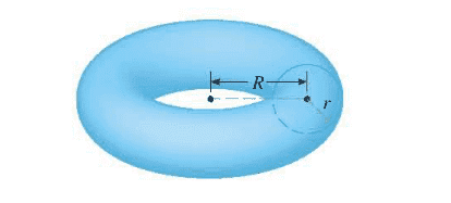

Use cylindrical shells to find the volume of a torus with radii r and R.
V= ∫[a,b] 2πxf(x)dx
y= sqrt(r2 - (x-R)2)
V= ∫ [R, R+r] 2πx sqrt(r2 - x2 - 2xR + R2) dx
I feel like this isn't going in the right direction, though. I found a different post about the same question, but that person was using disks, and the volume was 2π2r2R, and I can't see where the π2 would come from in my equation, so I think I'm going about this incorrectly. Any help is much appreciated, thanks.

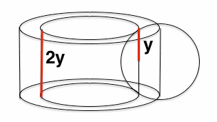

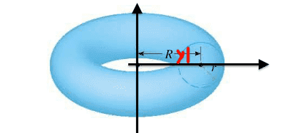

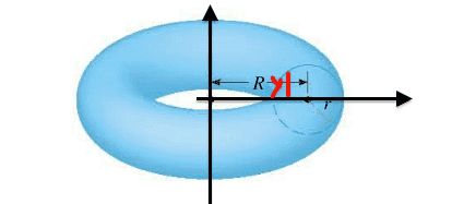

Would h be 2y, since the height of the cylinder depends on the curve of the torus? So for any point on the torus, where the circular cross section lies in the xy plane, y=sqrt(r2-(x-R)2). Then the cylindrical shell would dip above and below the x axis, so the height should be 2y, right?
Like this, if that helps clarify at all.
That looks good to me. It appears to agree with Simon's comment.
That's what I was thinking - nice pics BTW.
There is no arguing with a decent sketch - people used to say "God is a geometer".
So now you have the volume of the cylindrical shell radius x: R-r<x<R+r, is $$dV = 4\pi x \sqrt{r^2-(x-R)^2}\; dx = f(x)\; dx$$... now it is just a matter of adding up all the dV's.
Since these are infinitesimal thickness shells, the summation sign is replaced by an integral over appropriate llmits. $$V=\int_V \; dV = \int_{a}^{b} f(x)\; dx$$ ... writing that out, with correct numbers for a, b, and f(x), is the next step - then you can use a substitution.
