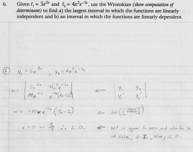

D.E. Wronskian Method: Stuck trying to show L.I. and L.D. intervals
In summary, the wronskian test is a test used to determine whether two functions are linearly dependent or independent on an interval. If the wronskian test is nonzero anywhere in the interval, then the functions are said to be linearly dependent on the interval.
Jeff12341234
179
I need to show the intervals where the wronskian is linearly independent and linearly dependent.. I don't know how to do that.. Here's what I have:
Odd question. The functions are linearly independent on an interval if the Wronskian is nonzero ANYWHERE in the interval.
So what is the next procedural step?
Procedure is done. Next step is to think about it. The wronskian vanishes only at 0 and 2/7. Can you think of any intervals where the wronskian vanishes? Don't think too hard. I don't think the question makes much sense.
Did you understand Dick's reply? There is no positive length interval on which those functions are linearly dependent. Once you see that, there's nothing left to do. Unless you want to consider a single point as an interval.
[Edit] I didn't see Dick's second reply, sorry.
No, I didn't understand it. I need to see some sort of visual, physical representation of what's going on. :/ It's all just made up vocabulary for made up concepts at this point. All I know is that if you can solve for x, you call it the vocabulary word, Linearly dependent. If not, you call it linearly independent.

That's ok. An interval consisting of a single point is also pretty uninteresting. That makes the two functions just numbers. Always linearly dependent on single point intervals no matter what the wronskian. I can't figure out whether the person that wrote the question doesn't understand wronskians or is just trying to make a 'trick' question.

I was wondering the same thing. This sort of problem usually comes up where the point is to show the student how the Wronskian vs. linear dependence differs for two solutions of a 2nd order linear DE vs. two arbitrary functions. But this exercise completely misses the target if indeed that was the target.

Two functions are said to be linearly dependent on an interval if there are two constants a and b not both 0 such that a*f1(x)+b*f2(x)=0 on the whole interval. If not then they are linearly independent. That's all. What's important here is that you learn what the wronskian has to do with that. I told you but also see here. http://en.wikipedia.org/wiki/Wronskian#The_Wronskian_and_linear_independence
So what should I write to answer part a and part b?

Given what you've been told, tell us what you think. Take the interval (1,2). Linearly dependent or independent? Why? How about (-100,100)?

1. f1=x, f2=x^2 and f3=3x-2x^2 are linearly dependent, because f3=3*f1-2*f2. One of the functions can be expressed in terms of the others in a linear way. I think 'linearly dependent' sums it up pretty well.
2. Your wronskian is nonzero at x=1, x=2, x=3, x=pi, x=(-1), x=0.3182, etc etc. The only places it's zero are x=0 and x=2/7. You solved it. I'm not sure what you are asking.
3. Work out the wronskian of x, x^2 and 3x-2x^2 if you want to see what "identically zero" means.
1. So it would seem that a more intuitive definition of 'linearly dependent' would be that "one of the functions can be made using the other functions" or, "the other functions can be substituted into the last function" or "the last function can be comprised of the other functions" or something to that effect followed by an example. That tells me a LOT more than the 'standard' definition does.
2. so it's nonzero everywhere except for 0 and 2/7? If so, that's simple enough. What does that have to do with anything though? What does that actually tell me?
3. When you work that out, you just get 0

It tells you the functions are linearly independent. You don't even have to solve for x to know your wronskian is nonzero. Just put in x=1. You get -20e^(-3)(5). That's nonzero. So the functions are linearly independent on any interval containing x=1.
But I wrote down that they are linearly dependent which I based off of my notes. I don't know what to put for part A and part B. (2/7, inf)? (-inf, 0)? (0, 2/7)?
This supposed to be a test to see if your answer is right but getting any kind of meaning out of the results of the test is where I don't follow.. So you solve for x and you either get one or more x values or you don't. Where's the connection between that, and knowing if your general solution to the D.E. you were trying to solve is correct? If you get results for when solving for x, that means the solutions are linearly dependent. "If there is a point where the wronskian is nonzero, then he's all done" It's nonzero everywhere except 0 and 2/7 so that means the answer is right... I guess, but that doesn't tell me what to put for part A and B
Start with your guess of (2/7,inf) as an answer for A. Are the functions linearly independent on (2/7,inf)? Why?
I don't have any idea how to answer your question. I have no idea how to tell if the functions are L.I. or L.D. on a certain interval. Just guessing, I plugged in 2/7 into y1 and y2. That gave me 5e^(4/7) and 16/49*e^(-10/7) ...Is that supposed to mean something?

Why do you think that has anything to do with linear independence? The wronskian tells you something about linear independence.

Yea, but I don't understand how intervals come into play. I just take the functions (y1, y2, y3, etc), make them into a square matrix, run the determinant function on the square matrix, set answer equal to zero, solve for x, if x can be solved for the label "Linearly Dependent" gets written down, other wise, it's labeled L.I. I also know that for L.D. functions, the last one can be recreated using the previous functions. How that applies to anything or can be used for anything i don't know. That's all I understand so far. None of that helps me answer the question.

If the wronskian is nonzero at any point on the interval then the functions are linearly independent on the interval. Period. That's all you need to know. Don't bring a bunch of other confusion in that will interfere with that.
If the Wronskian is ≠ 0 at any value of x at all, then the functions are linearly independent on ANY interval whatsoever. Pick any interval you like; the functions are linearly independent on that interval. Pick another interval. The functions are also linearly independent on that interval. What, exactly, do you not understand about those statements?
ok, so this set of solutions is L.I. along (2/7, inf), (-inf, 0), and (0, 2/7) and L.D. on the point x=0 and x=2/7 ?
Are they linearly independent on (-inf,inf)? Don't worry about x=0 and x=2/7, yet.
According to your previous statement they are. ("If the Wronskian is ≠ 0 at any value of x at all, then the functions are linearly independent on ANY interval whatsoever.") The wronskian equals zero at 2 points so everywhere else it doesn't equal zero. Therefore, since it qualifies for the "doesn't equal zero at any point at all" condition, they must be L.I. That logic would also mean the the wronskian is going to be L.I. like 99.99% of the time unless you get 0 as an answer.
That wasn't my statement, that was Ray Vickson's statement and I wouldn't agree with it. Mine was, "If the wronskian is nonzero at any point on the interval then the functions are linearly independent on the interval." To justify that they are linearly independent in (-inf,inf) just give a value of x in (-inf,inf) where the wronskian is nonzero.
ok. It's nonzero everywhere except x=0 and x=2/7.. soo... it's L.I. ? If no interval is given by the question, I guess (-inf,inf) is assumed to be the interval.
I picked (-inf,inf) because part A is asking for the largest interval where they are LI. (-inf,inf) is the largest interval I can think of. And yes, they are LI.

That is false in general. If the Wronskian of two functions is nonzero anywhere on an interval, the functions are linearly independent on that interval. But the Wronskian of two functions can be identically zero on an interval yet the functions are linearly independent on that interval. It makes a difference if the functions are solutions of a second order linear differential equation with certain hypotheses. Only then can you say that their Wronskian is either identically zero or never zero. Surely your text has a theorem about this.

Mostly correct. If you read the wikipedia article carefully, it will give you an example of two functions where w=0, but they are linearly independent. w=0 usually means they are linearly dependent, but there are exceptions. To show functions are linearly independent on an interval (a,b) you don't HAVE to solve for x. All you have to do is find a point x in (a,b) where w(x)≠0. If solving for x is the way you want to do it, that's fine.
Planetmath is usually a good source, but I'm going to have to take issue with their saying x, x^2 are LI except at 0. There are LI on (-inf,inf). No 0 exceptions. Remember all you need is ONE POINT in an interval where w(x)≠0 to show LI. The fact there are isolated points where w=0 doesn't change anything.
If you want to talk about linear independence on an interval consisting of a single point, like [0,0] then that is a whole different issue and doesn't have anything to do with wronskians. On a single point interval both functions are just numbers, and two numbers are always linearly dependent, whether the wronskian is zero or not.
