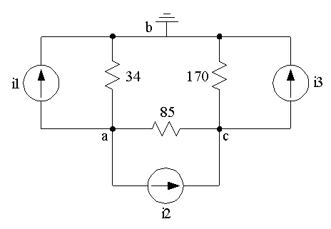

Here's your Δ configuration redrawn with current supplies in place.
I chose node b as the reference node for convenience. You could perform superposition analysis, suppressing two sources at a time and working out the resulting node voltages, or just do nodal analysis for the whole circuit to find the potentials at nodes a and c (with respect to the reference node b); The math then handles the superposition for you.
With Va and Vc in hand, you can then take differences to determine Vab, Vac, etc.
If you do a similar analysis for the Y configuration and arrive at the same set of equations for Vab, Vac, Vbc, then the circuits are externally indistinguishable.

Ah. The reference node, indicated with the ground symbol, is just there to facilitate nodal analysis (if you choose to use it). Otherwise the circuit is just your Delta circuit with current sources "bolted on".
When doing nodal analysis, the procedure is to pick a reference node and arbitrarily assign it as the "zero" reference for other potentials in the circuit (as though you were to attach your voltmeter's negative probe there and poke around the rest of the circuit with the positive probe). Then the potentials at the other nodes are obtained by writing nodal equations with that node as a reference.
I think I'm understanding a little bit more now. I was unfamiliar with the reference node symbol and interpreted it as a voltage source, which made the topology seem strange. As long as I'm consistent with my definitions of reference node and the directionality of the current sources, equality between the delta and wye should be provable. Should I choose to change the reference node or direction of the current sources, my voltages would differ I'm assuming.
You are free to choose the current source directions any way you wish, but stick with your choice throughout; It would make sense to keep consistent current source directions since you want to stimulate both arrangements in identical fashion.
You can choose any node you wish as the reference node in either circuit. The particular potentials at given nodes with respect to an arbitrary reference point are not as important as the potential differences between pairs of nodes -- the Vab, Vac, Vbc potentials.

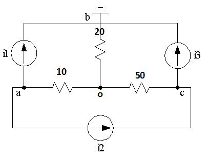

Let R1 = 10, R2 = 20 and R3 = 50
Suppressing I2 and I3:
Equation 7
(VA - VO)([itex]\frac{1}{R1}[/itex]) = I1
Equation 8
(VA - VO)([itex]\frac{1}{R1}[/itex]) - (VO)([itex]\frac{1}{R2}[/itex]) = 0
Eq 7 + Eq 8
(VO) = I1R2
(VA) = I1(R1 + R2)
Suppressing I1 and I3:
Equation 9
(VA - VO)([itex]\frac{1}{R1}[/itex]) = I2
Equation 10
(VO - VC)([itex]\frac{1}{R3}[/itex]) = I2
Equation 11
(VO)([itex]\frac{1}{R2}[/itex]) + (VO - VA)([itex]\frac{1}{R3}[/itex]) + (VO + VC)([itex]\frac{1}{R3}[/itex]) = 0
Eq 9 & 10 + 11
(VO)([itex]\frac{1}{R2}[/itex]) - I2 + I2 = 0
VO = 0
VA = I2R1
VC = -I2R3
Suppressing I1 and I2:
Equation 12
(VC - VO)([itex]\frac{1}{R3}[/itex]) = I3
Equation 13
(VC - VO)([itex]\frac{1}{R3}[/itex]) - (VO)([itex]\frac{1}{R2}[/itex]) = 0
Eq 12 + Eq 13
(VO) = I3R2
(VC) = I3(R2 + R3)

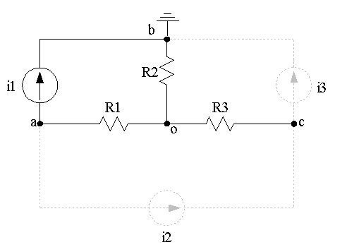

When you suppress two current sources in this Y configuration, you should note that it leaves a "floating" node. For example, suppressing i2 and i3 leaves node c unconnected. While no current will flow through R3 in this situation, nevertheless node c will have a potential! It will have the same potential as Vo where the other end of R3 is connected. You need to include these potentials in the superposition reckoning.
I've tried a source transformation; however, it just seems strange on the wye-configuration.
What sort of source transformation were you looking at? No obviously helpful transformations jump out at me when I look at the circuit.

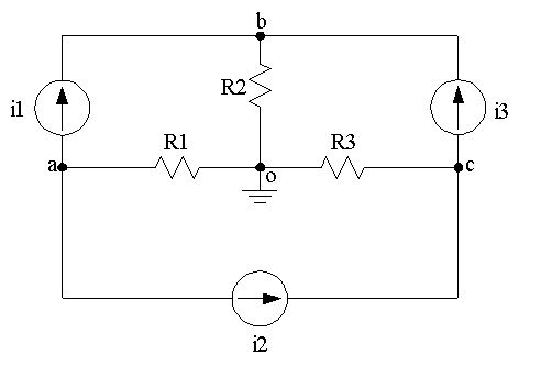

If I may make a suggestion about the Y circuit analysis, the central node you've labelled "o" in your diagram is entirely internal to the "black box", so you don't need its value when comparing the two configurations. Why not take advantage of this by moving the reference node from b to o?
It also has the advantage that the potentials of open nodes will be zero, so there's nothing to "carry along" for them for the superposition sum.

I see. The lack of current across the wire connecting o and c means no voltage potential drop; however that doesn't mean no voltage potential. In my diagrams, I took to the habit of completely dropping open circuits but now I see why that's incorrect.
As for the reference node, o is a better choice because it connects to more wires I suppose.
Out of desperation, I tried to transform the current source and R2 resister into a voltage source and parallel resistor but there was always a resistor in the way. I'm sure this is incorrect.
You mentioned the direction of the current decides the direction of voltage drop; however I2 seems arbitrary. I'm assuming the sign would've worked out either way to give the right direction. Does this mean that only I1 & I3 are determine the direction of voltage drop?
That's often a good indicator, and generally leads to tidier equations.
Yup. None of the current sources are candidates for transformation.
All three current sources contribute to the potentials (via superposition). Since as variables they can have arbitrary values (including negative values), their assumed directions are really only a book keeping measure to keep the equations self consistent.
But if I1 and I3 were positioned downward, would I still come up with the same voltage drop? By same voltage drop, I mean the signs in front of I1 and I3 change as a result of the sign change. (i.e. +2(+1) changes to -2(+1) where each +1 is in reference to a different direction so the second +1 is really -1 with respect to the co-ordinate system of the first). In this case, wouldn't it be so that the voltage drop is always towards the reference node regardless of assigned directions. If so, why? If not, then what's the behavior of assigned current directions and voltage potentials and why? I understand the computation behind nodal analysis but this detail is bothering me because it appears to be fundamental.
If you change the directions of one or more of the currents you'll change the signs of one or more coefficients of the resulting voltage equations (Vab, Vcb,...) This is why it's important to have the same currents in the same locations and orientations for both circuits if you wish to compare them.
When you calculate a potential between nodes it's up to you to choose the direction that you want to consider "positive". It's like which node you place the negative lead of meter on, and which the positive lead; switch the leads around and the sign of measured voltage changes while the magnitude remains the same. So, for example, Vac = -Vca.
For a given setup of the current sources, you should arrive at the same set of equations for the oriented potentials Vab, Vcb, etc., regardless of which node you choose for the reference node.
Alrighty. I think I understand now. The only thing that's certain are potential differences, however the potentials themselves may differ, as in mechanics when it comes to gravitational potential.
Thank you so much sir for answering all my questions and helping me understand the nitty-gritty details of this problem. Most of the stuff about circuit analysis (Nodal Analysis, Mesh Analysis, Superposition Theorem, etc.) wasn't in my book and I either learned it here from you or heard about it so I knew what to further investigate.
I'm glad I could help. I was impressed by your dedication to solving a general case, rather than just the specific case with the given resistor values.
