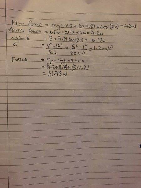

In summary, a 5kg block is pulled up an incline with a 20 degree angle, a coefficient of friction of 0.2, and a distance of 10m. Using D'Alembert's principle, the net force on the block is found to be 12N. Using conservation of energy, the work done on the block is calculated to be 198.28J, resulting in a pulling force of 19.828N. Both principles are used to compare and contrast the results for the assignment.
GrimUpNorth
A block with a mass of 5kg is pulled up an incline with a 20 degree incline, the coefficient of friction is 0.2 and the distance 10 metres. The block accelerates from 1m/s at point A to 5m/s at point B.
I have to use both D’Alembert’s and Conservation of energy principles.
Does the following look correct? I only have one chance to get it right so want to make sure it’s correct.
Frictional force=µ*M*g*cosӨ
a=(v2-u2)/2s
Net force=Ma
t=(v-u)/a
W + PE(initial) +KE(initial) =PE(final) +KE(final) +Heat lost due to friction

Though you do not say so, I assume you are trying to solve for the force applied to pull the block up the ramp.
You have an arithmetic error here:
GrimUpNorth said:
a=(v2-u2)/2s
= (25-1)/2*10
=2.4m/s2
I would not use conservation of energy here since friction is a non-conservative force. You do account for the heat lost to friction, but I think you are making things unnecessarily complicated. I suggest that you write the equation for the net acceleration up the ramp, including the pulling force, friction and component of the force of gravity pulling down the ramp. You can also find the net acceleration in terms of the distance traveled and initial and final velocities of the block. Set the two expressions for net acceleration equal and solve for the pulling force.
Likes GrimUpNorth
You have an arithmetic error here:I would not use conservation of energy here since friction is a non-conservative force. You do account for the heat lost to friction, but I think you are making things unnecessarily complicated. I suggest that you write the equation for the net acceleration up the ramp, including the pulling force, friction and component of the force of gravity pulling down the ramp. You can also find the net acceleration in terms of the distance traveled and initial and final velocities of the block. Set the two expressions for net acceleration equal and solve for the pulling force.
Thank you, I have to use both principles and then compare and contrast the results for the assignment.
Thank you, I need to use both principles for the assignment.
Does this look a better equation to use?
GrimUpNorth said:
Thank you, I have to use both principles and then compare and contrast the results for the assignment.Thank you, I need to use both principles for the assignment.
Yes, I think you have the right numerical answer now. That will give you something to check the other methods against.
