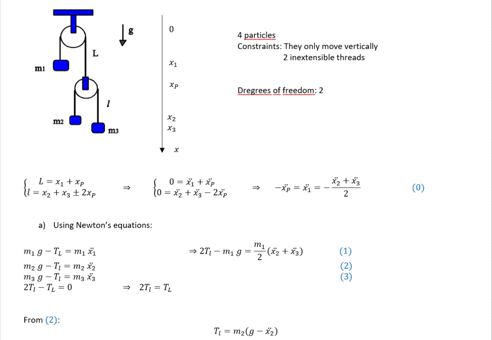

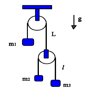

Given the system described in the picture, find the acceleration of every mass using:
a) Newton's equations
b) D'Alembert's principle
Note: Pulley's masses are negligible.
[tex] \displaystyle\sum_{i=1}^N (m_i \ddot r_i - F_i) \delta r_i = 0 [/tex]
This is the problem's picture:

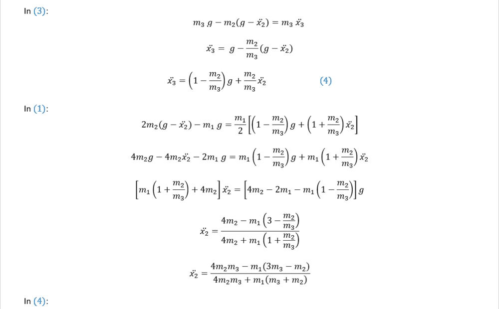

My problem is that what I got for one acceleration (m3's) via Newton's equations is not the same as via D'Alembert's principle (I've checked on my PC if they are the same expression).
I can't find the mistake. Any suggestion is welcome.
I attach pictures of what I did:
Thank you!

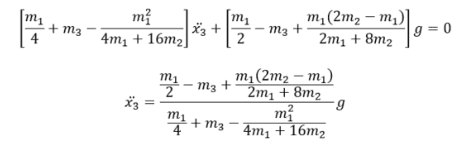

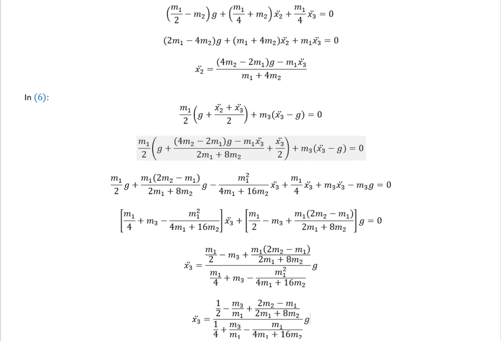

It looks like you set up both methods correctly. I did not check all of your work, but I did check to see if your two answers for ##\ddot x_3## match.
Your Newton's law result is
Your D'Alembert result is
When solving the first equation here for ##\ddot x_3##, you missed an overall negative sign. (Maybe you just forgot to type it.) Other than that, your two results for ##\ddot x_3## are equivalent.
The result can be simplified to look a little nicer with some manipulations. Try taking your result from Newton's law and combining the terms to make one fraction.
Likes LuccaP4 and Delta2
Yes, I typed it wrong (copy-paste from above :doh:) but wrote it right. The numerator is negative.
So if they're equivalent, I'll try simplifying the result and go on with the other accelerations.

I solved it, thanks for the help. I attach the entire solution, if anyone is interested.
