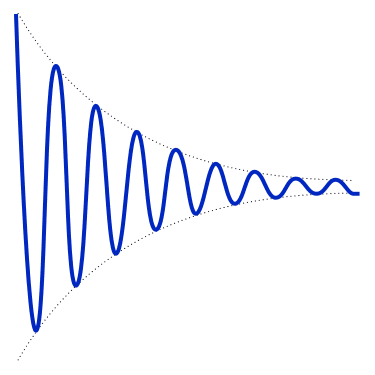

the formula for damped oscillations is given as x = Ae^(-bt/2m) cos(ωt+Φ)
so why is the amplitude as a function of time given as only the first part?
meaning only A(t) = Ae^(-bt/2m)
it "ignores" the 2nd term which is the oscillating cosine term. which still encompass a time t value too...
so how come the amplitude function is given as so ?

Are you asking why the amplitude decay is independent of the wave shape?
A wave is in the form x = A*cos(wt+phi), there is no reason that A, w, phi cannot also vary with time to give a more complicated wave. The multiplication of A with the wave shape (the cosine term) means the wave gets smaller in height as time goes on, which reflects our observation of decaying oscillations.
I don't really understand the question,
Do you disagree that the function represents a decaying wave?

The graph below shows the final wave, and the amplitude is the dotted line. So the overall wave is being "squashed" over time because the amplitude is dropping.
oh ya... its exponential lol
er from your graph, does it always mean that within the same section of 1 wavelength, like the 2nd crest to the 3rd crest,
the amplitude( from middle to 2nd crest , and from middle to 2nd trough), is the same?
No, the amplitude is continuously falling over all time.
