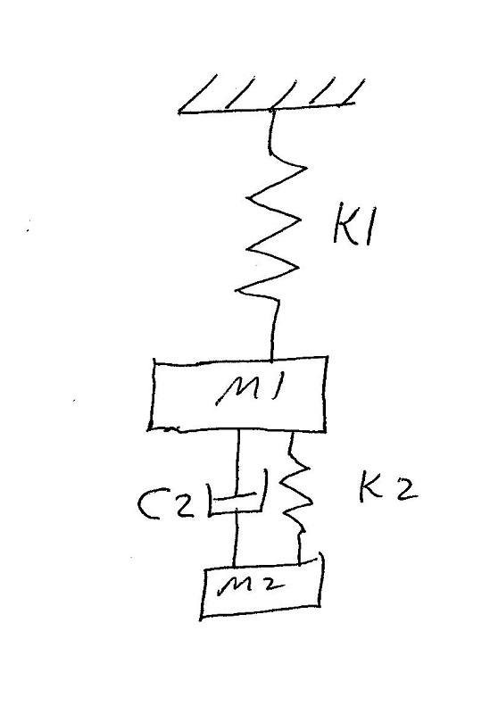

The building by itself is a simple single degree of freedom (1 DOF) spring mass system. It has a single natural frequency, and minimal damping. Adding a second spring and mass (the TMD) adds another natural frequency. A typical TMD has mass that is a fraction of the mass of the building with natural frequency close to that of the building, so the two natural frequencies of the 2 DOF system are close to the original natural frequency of the 1 DOF system. The lower natural frequency of the 2 DOF system is below the original 1 DOF natural frequency, the higher natural frequency of the 2 DOF system is above the original natural frequency of the 1 DOF system.
An undamped TMD is useful when a system has a single frequency excitation at its natural frequency. It moves the natural frequency to two frequencies, neither of which align with the excitation. Since the system is no longer at the excitation frequency, it does not resonate.
A damped TMD is used when there is a broad range of excitation frequencies AND where it is not possible to connect a damper directly from the vibrating object to ground. In a multi-DOF spring-mass-damper system, a damper anywhere in the system reduces vibration in the entire system. A crude way of putting it: Vibration energy transfers to the tuned mass, the damper takes energy out of the tuned mass, which sucks vibration energy from the original mass.
As alluded to in the video, there is an optimal amount of damping. Zero damping removes zero energy, so does not reduce vibration. Infinite damping locks the tuned mass in place, with the result that the mass is added to the mass of the structure. Again, there is no reduction in vibration. Somewhere in between, there is an optimal amount of damping to get the best vibration reduction.

The definition of a viscous damper is ##Force = C * V##, where F is force in ##lbs##, C is the damping coefficient with units of ##lb-sec/ft##, and V is the velocity in ##ft/sec##. Damping force opposes velocity. If there is no velocity, there is no damping force. If the damping coefficient is zero, there is no damping force. If the damping coefficient is very large, a small velocity has a very large force. If the damping coefficient is infinite, any microscopically small velocity has an infinite force. In that case, the damper is effectively a rigid link.
Here is a schematic of a spring-mass system with a damped TMD:
M1 is the mass of the system, K1 is its spring constant. M2, K2, and C2 are the tuned mass mass, spring, and damper. The damper is attached to the tuned mass because there is no practical way to attach a damper to the system (building in this case).
You will need to spend some time studying the schematic while studying Post #2 to wrap your mind around the concepts of zero damping, optimal damping, and infinite damping and how they affect the overall system. Good search term for general background is spring mass damper system.
