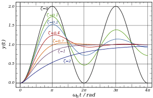

This is not right, but the connection can be seen here:
The ga
Hesch said:
Correction:
is the graph wrong because zeta should be 1 instead of 0.4 when critical damping occurs? I think I understood the concept.
No, I trust the graphs, but my expression in #2:
Amplituden+1 = Amplituden * ( 1 - ξ )
was simply wrong.
Maybe you could calculate the correct expression? ( 1 - ξ ) must be substituted by something else ( f(ξ) ).
Critical damping is when ξ = 1. No damping is when ξ = 0. In "typical" analog controllers as for temperature, motorspeed, a ξ = 0.65 . . 0.7 is often chosen, which compromises control speed and overshoot. In digital controllers a ξ = 1 is often chosen.

I tried working the amplitude expression out,
https://www.google.com/search?q=damping+ratio+formula&es_sm=91&source=lnms&tbm=isch&sa=X&ved=0CAcQ_AUoAWoVChMIn-qy07aPxwIV1Y-OCh2PVwZU&biw=1277&bih=637#imgrc=ArC96HvFuNB9TM%3A
Since ξ is the ratio of damping coefficient of the system when critical damping occurs (Cc) to the damping coefficient of the oscillation (γ), ξ=γ/Cc. From this we have γ=ξ*Cc--(1)
The expression for variation of amplitude with time is Ae^(-γt), so if we sub. (1) into the expression we get Amplituden+1 = Amplituden*e^(-ξ*Cc)t
Yes, that is right: If we damp an oscillation ( say sin(ωt) ) the sin(ωt)-function will be enveloped within a ±exponential-function. But if you look closely at the graphs in #6, you will see that the damped sin(ωt) has a somewhat lower frequency than the undamped sin(ωt): Thus the amplitude (peakvalue) will be somewhat smaller than
Amplituden+1 = Amplituden*e^(-ξ*Cc)t.
The ξ could be formulated as:
Say you have a characteristic equation: s2 + 2s + 2 = 0 , you will find the roots z=( -1 + j1 ) and z=( -1 - j1 ). If you plot these roots in a root locus, and draw two lines through ( 0 , 0 ) and ( -1 ± j1 ) we could call the angles between these lines and the imaginary axis φ ( = 45° ). Then ξ = sin(φ) = 0.7071. So if you want a ξ = 0.6 , the roots of the characteristic equation must be on two lines with an angle = arcsin( 0.6 ) as to the imaginary axis ( = 36.87° ).
Critical damping is exactly when the roots close up on the real axis ( φ = 90° , ξ = 1 ):
