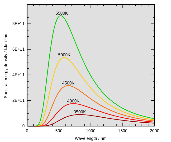

The hotter the star, the further on the spectrum is the peak radiation intensity. For any wavelength, intensity increases with temperature. It's just that as stars get hotter, larger proportion of light is in the shorter wavelengths, making the star look bluer.
Below is the black body spectrum, which closely approximates stellar output:
As you can see, it 'leans' to the left with increasing temperature (as described by Wien's displacement law). You can imagine a body so hot, that its peak wavelength is way in the gamma range. It would still look blue, since that's where the most intensity in the visible range (~400-800 nm) would be radiated.
