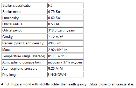

I am actually an MD student, but I have been working on writing a novel. I wanted to create exoplanets that were suitable for human habitation, and I had a guy help me over the summer come up with plausible numbers for a variety of variables. Where I am having trouble now is figuring out how long a year would be on these planets as well as the length of an individual day. I attached the data that the individual gave me on some other variables.
If I wanted to figure out from this data:
- Apparent luminosity (at planet)
- Orbital period
- Day length
- Apparent luminosity (at planet): 1.67657
- Orbital period: 0.715 Earth years
- Day length: ?
I am not certain that any of these is correct, and I don't even know how to begin to figure out the last parameter (day length).

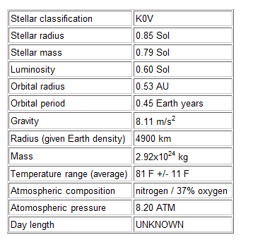

Ok, I calculated the orbital period (but I am not sure it is correct.
To be clear, in my story, humans only visit this world. I'm not sure that these variables are correct, again, a high school science teacher I paid came up with most of these.
Is my calculated orbital period correct? (I double checked it, so unless I had my units wrong)
Do you think that temperature range seems incorrect given the other variables just by eyeing it?
The orbital period is enormous... a planet whose year is over 300 Earth years? But its supposed to orbit close to the star? I don't know seems like I might have this wrong.
The temperature range looks quite optimistic, with such a thick atmosphere and so close to the star a venus-like planet is much more likely. Your planet would get twice the solar intensity compared to earth, very similar to Venus.
The orbital period is way too long (even if it is supposed to be days instead of years), it should be less than half a year.
Also, it is unclear if that smaller planet can hold its thick atmosphere.
Check your numbers... In my calcs, the orbital period is much shorter...
The numbers aren't consistent. The given planet mass and radius don't yield a surface gravity of 7.72 m/s2. It would be a bit higher than that.
You should show your calculations, not just the results.
8.11 is what I got when I re-did it
I'm not sure what the person means "given Earth density" under radius.
Is it about 0.45 Earth years? that's what I got when I re-did it with correct units
The assumption that the new planet has the same average density as earth.
0.45 Earth years look right.
