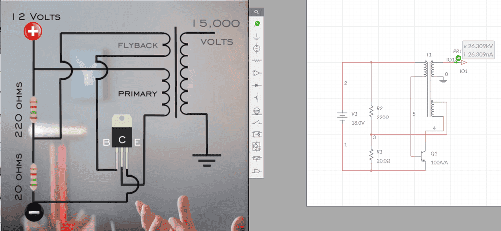

I found this schematic while watching the following video on building a DC 20kv power supply:

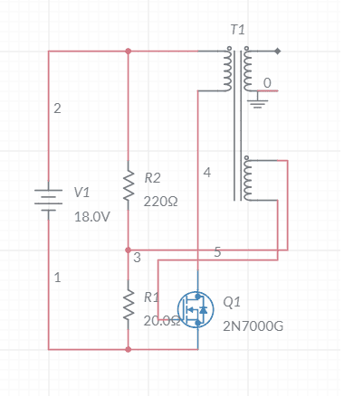

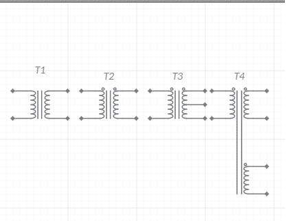

I wanted to test the circuit in multisim, but I'm having trouble finishing it. None of the transformers available look like the one used in this schematic. Below are the transformers available on multisim, but none of them worked above millivolts. I included one of my last attempts. Any help is greatly appreciated!
The circuit is for an NPN BJT that conducts base current.
You are modelling it with a 2N7000 MOSFET that does not conduct base current.

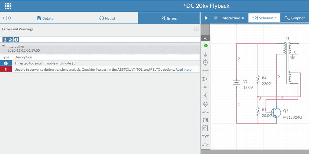

What does "none of them work above millivolts" mean?
Rated voltage of the simulation model ?
Oscillation signal amplitude observed in simulation result ?
1 millivolt = 0.001V and only the order of millivolt ?

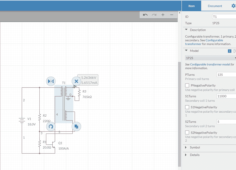

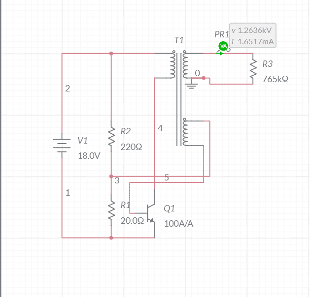

Thank you for quick the response! That definitely got the circuit running, but the max voltage and current are much lower than I thought they'd be (1.26kv, 1.65mA). Can't figure out what else I'm doing wrong.

How have you set up the transformer parameters?
What turn counts or ratios have you set up for the transformer windings?
What primary inductance?
I couldn't find any information on the turn ratio of a computer flyback transformer, so I used the turn ratio of an ignition coil: primary at 135 and the secondary at 11000.
Notice there is no capacitor to set the frequency. The frequency of operation is therefore determined by the inductance of the primary, the supply voltage, and any stray capacitance.
What inductance have you specified for the transformer primary winding ?
I'm very new to transistors and transformers, so I'm not sure how to calculate the inductance for this circuit. I'm working on it now.
With Multisym I believe you specify turn counts and the primary inductance. With SPICE we specify the inductance of each winding so it can calculate the turns ratio.
You used; Primary n=135. Secondary, n=11,000. Feedback, n=5.
I don't believe they are correct for an 18 V to 20 kV transformer.
The primary has too many turns.
I would have started with about 1 or 2 volts per turn, here let's say 2 volts / turn.
Primary V=18 V; n=9; n² = 81;
Secondary; 20 kV; n=10,000; n² = 100e6;
Feedback, V=5 V; n=3; n² = 9;
I computed n² also since inductance for SPICE is proportional to the turns count squared.
Use these n values for the turn counts on your transformer windings.
I guess the magnetising current in the primary will be about 20mA.
18Vdc ≈ 6.5 Vrms.
XL = 6.5 Vrms / 20 mA = 325 ohms, reactive.
XL = L · 2 · π · freq; ∴ L = XL / ( 2·π·f )
Guess at a frequency, maybe about 5 kHz.
An estimate of the primary inductance; L = 325 ohms / ( 2 · π · 5 kHz ) = 0.010 = 10 mH.
With those values, my LTspice model produces 25 kV pulses at 4.85 kHz.

Thank you so much for your help on this. Other than the issue with the number of turns, I figured out that the schematic connections for the transistor as I understood them (which is probably wrong since the transformers don't look the same) was incorrect. After connecting the bottom of the top transformer (which I've always thought of as the primary) to the base of the transistor and the bottom of the secondary to the collector I finally reached 26kV in simulation. I greatly appreciate all of your help with this!
You still have some way to go. You have swapped the base and collector connections.
The primary of the transformer must be connected between the positive supply rail and the collector of the transistor. There should not be a resistor in that collector circuit.
The two resistors make a base bias circuit. The midpoint must be connected through the feedback winding to the base of the transistor.
Change your turn counts to those I calculated earlier.
Likes HelloCthulhu
The turns were adjusted during the 26kV sim, but I've made the necessary changes to the transistor connections. Hope they're correct. New simulation just under 20kV.
Likes Baluncore
That now looks good.
