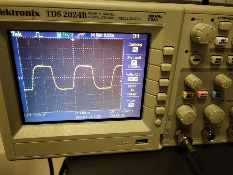

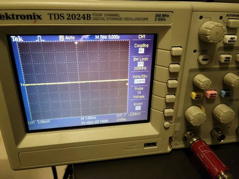

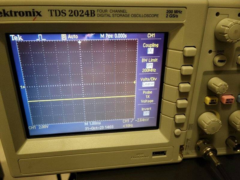

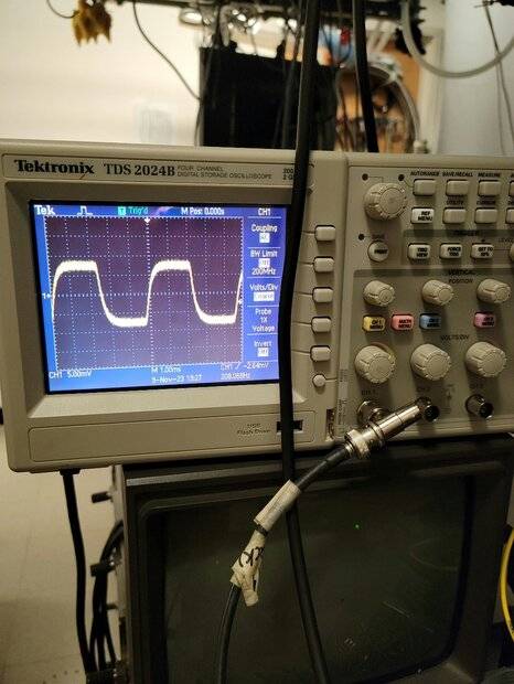

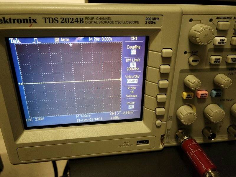

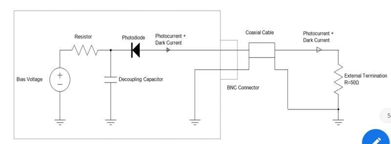

Hi all,
I was trying to detect small optical signal through amplification process and realized that there is a huge DC background behind the AC signal. So I decided to remove the background using a Thorlabs DC blocker (EF500). The photodiode I used was Newport 818-bb-21, and the signal before the blocker was ~5 mV heighted retangular waveform with 250 Hz frequency. However, it turned out that the signal gets messed with no DC and no AC after passing through the DC blocker. The attacheds are before/after signal from oscilloscope with DC/AC coupling. Could you help me out why it happened?

Can you upload a diagram of your circuit? Use the "Attach files" link below the Edit window to upload a PDF or JPEG version of it. Thanks.

Oh, I thought you built up the photodiode circuit yourself. Can you link to the respective datasheets then? Thanks.
Maybe your HPF filter (DC block) thinks your signal is too slow to let pass. Looks like about 100usec rise time, so maybe 3-4KHz. Most all DC blocks are intended for RF applications (>10MHz at least). Do you know the impedances involved (source, load, filter, etc?).
You could make your own with a big capacitor. In a 50Ω system you would use about 10uF in series with your cable. This would give you a 159Hz HPF with about 1.5dB attenuation at 250Hz; i.e you would lose about 15% of your AC amplitude.

The user manual said it blocks < 1 Hz signal, and I actually tested it for several different signals from different waveform generators. It worked perfectly, blocking DC and leaving AC, except the one from photodiode, which makes me more confused.
OK, I'm still not sure what your setup is, since you don't want to show us a simple block diagram or schematic. We are not clairvoyant. But it looks to me like the detector should have a DC reverse bias with the 50Ω load impedance shown in their schematic pulling one side to ground. If you put a DC block after the PD then you may not have the reverse bias they want.
So, let's go back to the question that we have both asked you before; what are your impedances? Are you using the 50Ω termination that the PD data sheet says you should?

Sorry for the inconvenience. The scheme is simple as follows:
Without DC blocker: PD - BNC cable - Oscilloscope
With DC blocker: PD - BNC cable - DC blocker - Oscilloscope
So you said I need a 50 Ohm load impedance after the PD to have the reverse bias. Since everything is connected with BNC cable and I am not familiar with this kind of electronics, which component should I use as a 50 Ohm impedance and how should I connect them with the current setup?

If you need to introduce a 50Ω load across the line from one box to the other then use a BNC T Piece and connect a 50Ω load to the third port of the T (they are available with all types of connector). That will provide a 50Ω path to ground.
It would help a lot, for you and us, if you could commit yourself to an actual diagram. It's no surprise that Electrical Engineers use diagrams in pretty well all circumstances. Block diagrams are often the best way.
Do you have a data sheet on the 'DC blocker'? Most filters need specific source and load impedances.

I think it doesn't work for my case. I tried to couple it as PD-BNC-T with 50 Ohm termination - oscilloscope. It seems the termination load eats all the signal and the oscilloscope shows nothing even without the DC blocker.
For the block diagram, the one for PD is all I have in the attached.
For the datasheet, I attached it as well. It says "use the source impedance of 50 Ohm and the load impedance of < 100 kOhm".

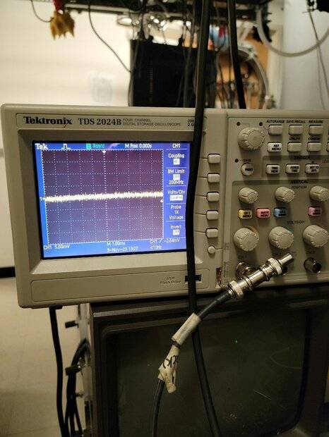

So basically this is how I ended up with the 50 Ohm termination, and no signal was shown. I wonder what I have missed or mixed up in this setup.

What are the values of the Bias Voltage and the Resistor for this circuit? I'm having trouble finding them in the datasheet.

Hmm, I don't get the need for a DC blocker if the 'scope AC input can be used instead. And I still don't understand the "DC noise" thing, since the dark current spec is <1nA, and the max signal allowed for this PD is 3mA peak into 50 Ohms...

Here is the scheme, and you can check it.

So I'd get rid of the DC blocker and external 50 Ohm termination, and just use the AC coupling and 50 Ohm input setting on the 'scope.
Are you saying that with the 'scope set on 1M Ohm input, you get the 10mVpeak signal, and with it set on 50 Ohm input you don't see any signal? What is your optical power? Are you sure your fiber is aligned well where you are inserting the signal and at the PD? How long is the fiber? What optical wavelength are you using?

So presumably if you only use the 'scope, you see this?
  • Input Coupling = DC, 1M Ohm, get 9Vdc offset and AC signal too small to see
  • Input Coupling = AC, 1M Ohm, get 10mVpp square wave signal
  • Input Coupling = AC, 50 Ohm, the square wave signal is too small to see
Is that right?
  • #33
Is that right?
I am not sure whether I understand the coupling concept, but let me rephrase what you said in my version.
1. I coupled the PD signal directly to scope with BNC cable. I set the scope as DC coupling and saw ~ 3 Vdc offset (not 9, idk why)
2. I coupled the PD signal the same way as I did in 1). I set the scope as AC coupling and saw ~ 10 Vpp square waveform.
3. I coupled the PD signal to the scope through the T connection with the 50 Ohm termination at the third end. I set the scope as AC coupling and saw nothing.
Are we on the same page now?

Sorry, where are you seeing that in the PD datasheet? I see this for the maximum linear photocurrent (your -21 model is the right-most column):

##\frac{10mVpp}{1M \Omega} = 10nA##

optical input is around several uW, which corresponds to several uA.
So ##(10 \mu A) (50 \Omega) = 1mVpp##
You need to have a low resistance like ##50 \Omega## to ensure that the PD is reverse biased well. If you try to use a ##1M \Omega## measurement resistance, the PD will not be reverse biased and the frequency response will not be very good.
So if you use the DC blocking coax thing (which I think presents ##50 \Omega## on the input (female BNC side) and go into a good preamp, you should get a reasonable signal. You could also use a spectrum analyzer instead to take advantage of its better input sensitivity.
Well, the thing is the signal already gets mixed up when passing through the DC blocker on the 50 Ohm side, as I showed you before (check the first pictures). I didn't even use the preamp yet.

Okay. I was just not used to the language in this community since I am in physics and didn't have any chance to work on electronics before. I didn't mean to confuse you. I will keep it in mind.
About what you said, I am kind of confused because when we think about the Ohm's law the voltage at the high impedance like the one in the scope should not change no matter it is connected to the low load impedance like 50 Ohm. Based on that, I can assume that there should be no difference on the PD signal when I add the 50 Ohm termination on the third end of T connector, just like the last pictures I uploaded. Here are my questions:
1) What makes the difference on detecting the signal through the scope when the 50 Ohm termination is added?
2) If the signal is detected through the termination add-up, why does the signal only matter the 50 Ohm termination but not the high impedance in the scope?
  • #46
The PD is a high impedance current source, so the resistance you terminate it into determines the voltage level you will detect.

1) What I understand is that there are two terminations: one at the scope with high impedance, and the other at the 50 Ohm termination with low impedance. If this is correct, why does the low impedance affect much even in the presence of the high impedance which is used for the detection?
2) If I need a reverse bias operation, should I build my own circuit? I think that's too much thing for me... I am not confident enough to make a precise measurement circuit that is required on my experiment.
As you said, I am trying to do the best way, making a working DC blocking circuit before the preamp, and that's why I want to figure out how to make it. I actually tried to amplify the PD signal with/without DC blocker, and it didn't work for both cases. They didn't show any signal just like what's shown in the current DC blocking setup. I just want to know why the signal disappears.
