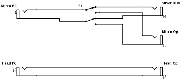

In summary: The problem is simple: in a room for audio conferencing there is a sound system with powered mixer, a PC with Skype and, for the moment, a mechanical switch (orribile!) that allows the user to interact with people connected on Skype and ask them to intervene as needed.I would simply replace the mechanical switch with an electronic one, and I thought that the IC MAX series 49xx are appropriate when supplied with dual voltage in order to avoid clipping of audio signals.Thanks for your reply.
AS you can see from the figure below, the switch has the only function to connect the PC line IN (Micro PC) to :
- the Mixer AUX output of the mixer, standard config (so that anyone who is connected with Skype will follow the lecture in the classroom) - or
- the Micro Op. of the operator, special config (to give instructions to those who connected, or ask to speak)
The Head PC - Head Op. line is to allow the operator to follow the classroom lecture.

The MAX4910 is a single voltage part.
Are you sure you don't want to just mix the signals, rather than switch?
https://www.amazon.com/dp/B000KGYAYQ/?tag=pfamazon01-20
Or you can get a USB sound card with a mixer, or just mix in the PC. Or just switch in the PC. Many options.
If you do decide on a mixer, be sure you have the correct plugs/adapters. Many are 1/4" mono.
Yes sure, they mainly need to switch the Micro Line from mixer/operator as already done by the mechanical switch.
The MAX4910 was just an idea, any other audio switch chip compatible with those signals goes well.
